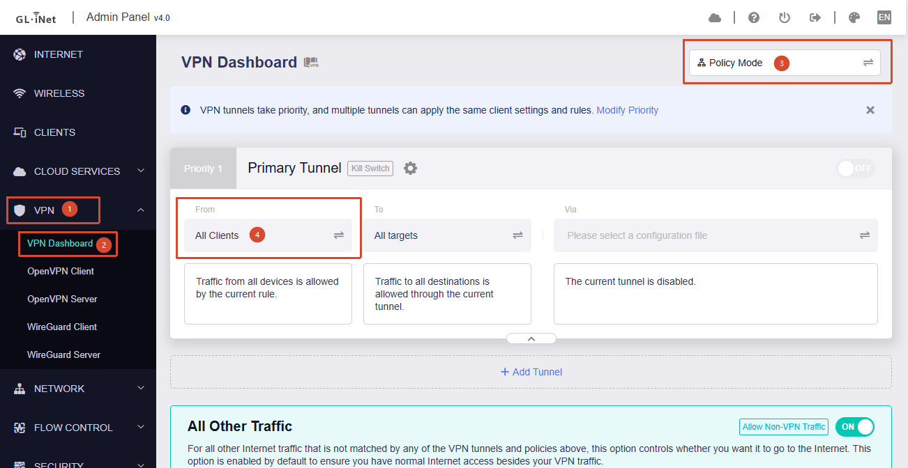

Could someone help me with the LuCI settings? How can I make it so only the wireless connections go through the VPN?
We currently do not support directly distinguishing between LAN devices or Wi-Fi devices connected to the Main network.
You may consider the following:

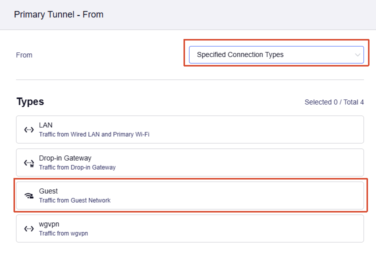

  1. Use the Guest Wi-Fi as a VPN-dedicated network. In this case, you can use VPN policy mode to route Guest devices through the VPN:
  2. The BE5800 only has a single Ethernet port, and in most cases it should only be connected to one LAN device. Therefore, you can directly exclude this device from VPN routing in VPN policy mode:
Thanks, this works for me :+1: The downside to this method is that devices connected to the wireless network can't access the WebUI. Hopefully in the future there will be support to separate the LAN and wireless main networks.
