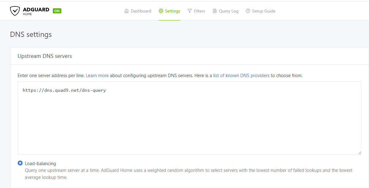

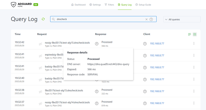

Yeah, as I said before, I'm using DoH Quad9.

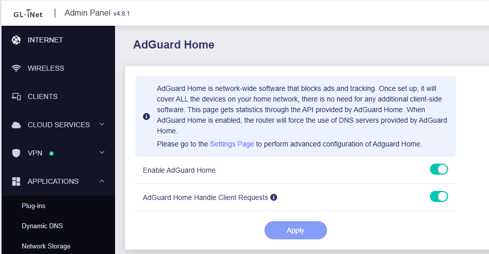

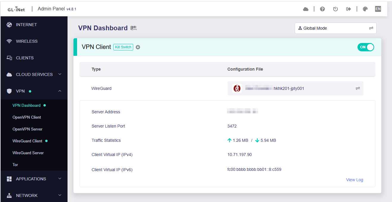

We conducted testing using the following configuration and were unable to reproduce the issue on Beryl AX with firmware version 4.8.1.

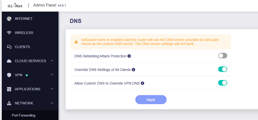

Router settings:

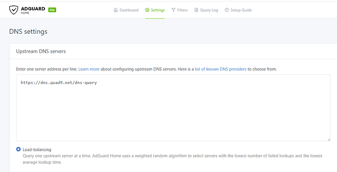

AdGuard Home settings:

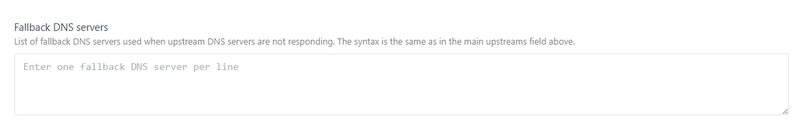

Only Quad9 DoH as Upstream DNS servers, no Fallback DNS servers

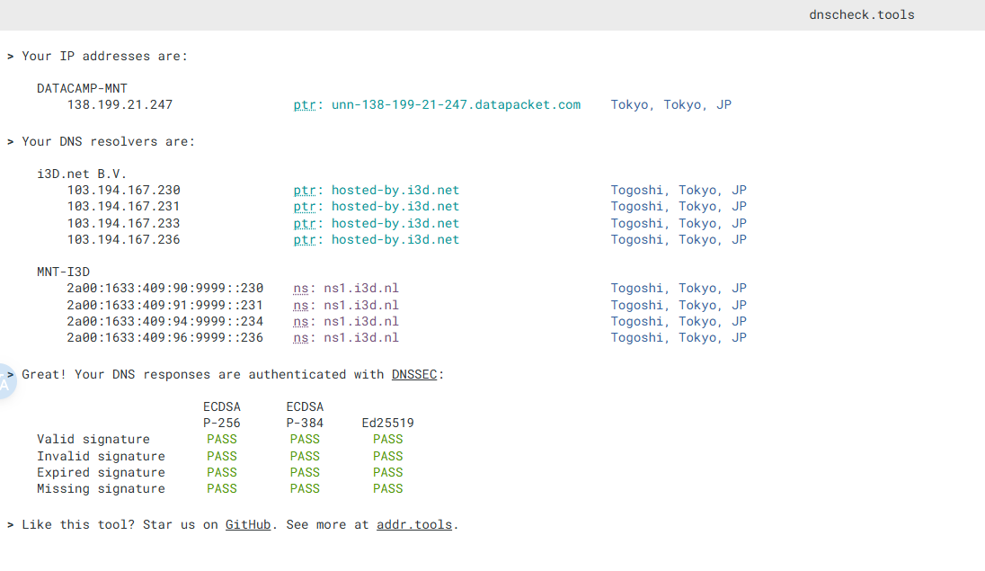

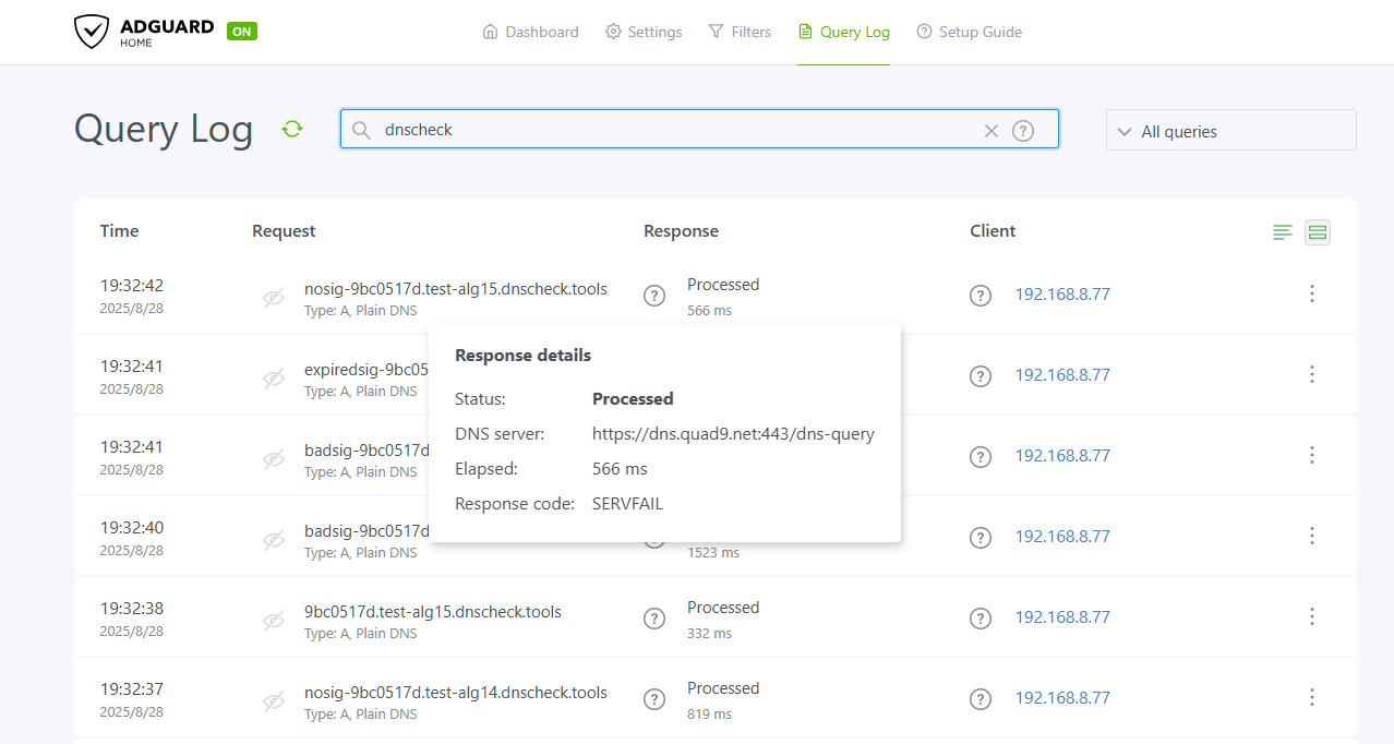

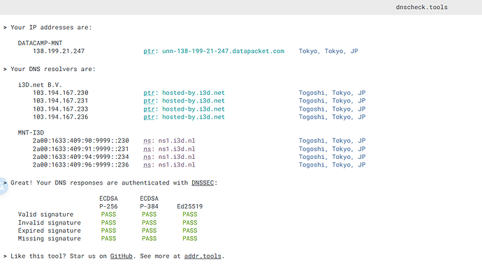

Test Results:
Yeah, that’s Quad9 all right; i3d.net is a member of their ‘multi-cast’ DNS network.
