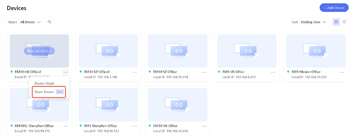

Hi @robotluo, I’m not sure if this is the same request but I’d like to bind a device to different accounts or have a master account that can “share” the device to other accounts.
The feature will be launched soon.

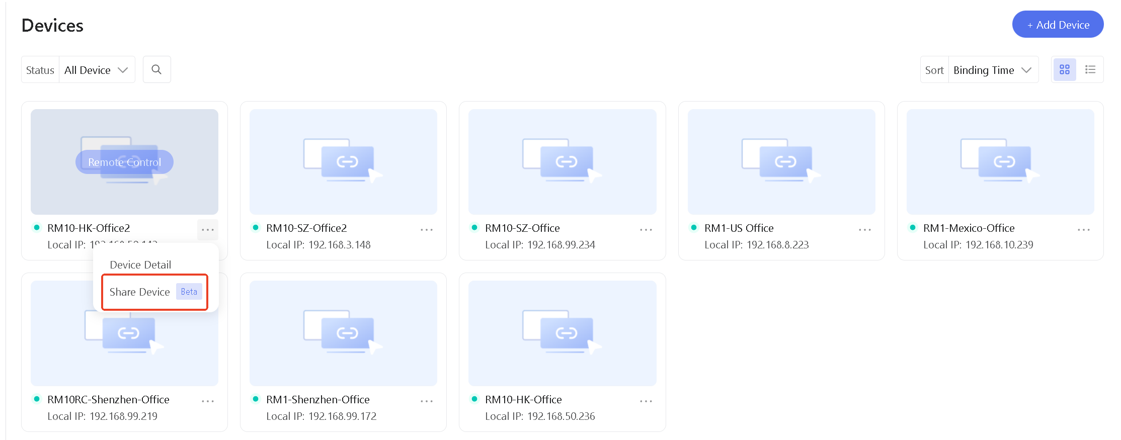

The device sharing feature is now enabled. You can use it through glkvm.com.
