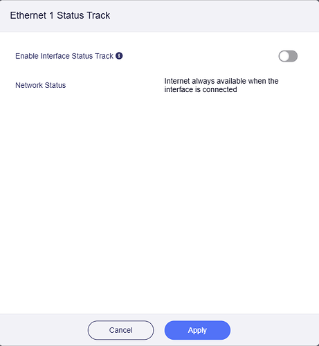

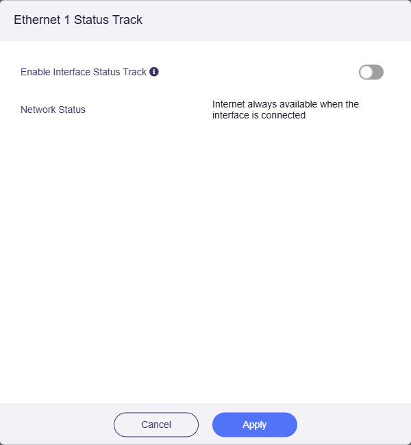

GL GUI > Network > Multi-WAN, this function is depended on kmwan to manage WAN interfaces.
kmwan and mwan3 implement similar functions. After you install mwan3, please disable and stop kmwan on SSH:
/etc/init.d/kmwan stop
/etc/init.d/kmwan disable
Or in GL GUI > Network > Multi-WAN, disable all interface monitoring.
