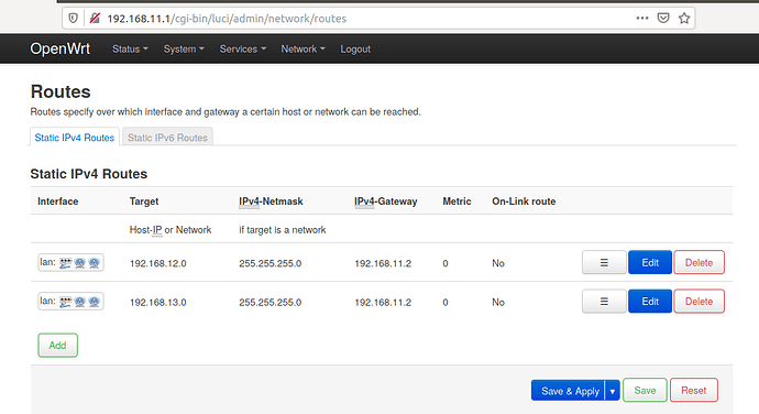

Within luci you will find the routes page, should look somehow like this:
There you will create a new route containing a target (your network B, so f.e. 192.168.22.0), the targets’ subnet mask (f.e. 255.255.255.0) and the IPv4-Gateway (which is the IP of the network B router)

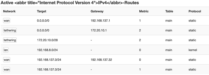

Hmmm… this does not work. I have added this rule:
interface=wan, target=192.168.137.0/24, gateway=192.168.137.32
Then, Status/Routing shows this when the internet is offline:
And the ping does not work:
% ping 192.168.137.32
PING 192.168.137.32 (192.168.137.32): 56 data bytes
64 bytes from 192.168.137.32: icmp_seq=0 ttl=64 time=0.712 ms
64 bytes from 192.168.137.32: icmp_seq=1 ttl=64 time=0.972 ms
64 bytes from 192.168.137.32: icmp_seq=2 ttl=64 time=0.688 ms
^C
--- 192.168.137.32 ping statistics ---
3 packets transmitted, 3 packets received, 0.0% packet loss
round-trip min/avg/max/stddev = 0.688/0.791/0.972/0.129 ms
% ping 192.168.137.1
PING 192.168.137.1 (192.168.137.1): 56 data bytes
Request timeout for icmp_seq 0
Request timeout for icmp_seq 1
Request timeout for icmp_seq 2
^C
--- 192.168.137.1 ping statistics ---
4 packets transmitted, 0 packets received, 100.0% packet loss
What gives?

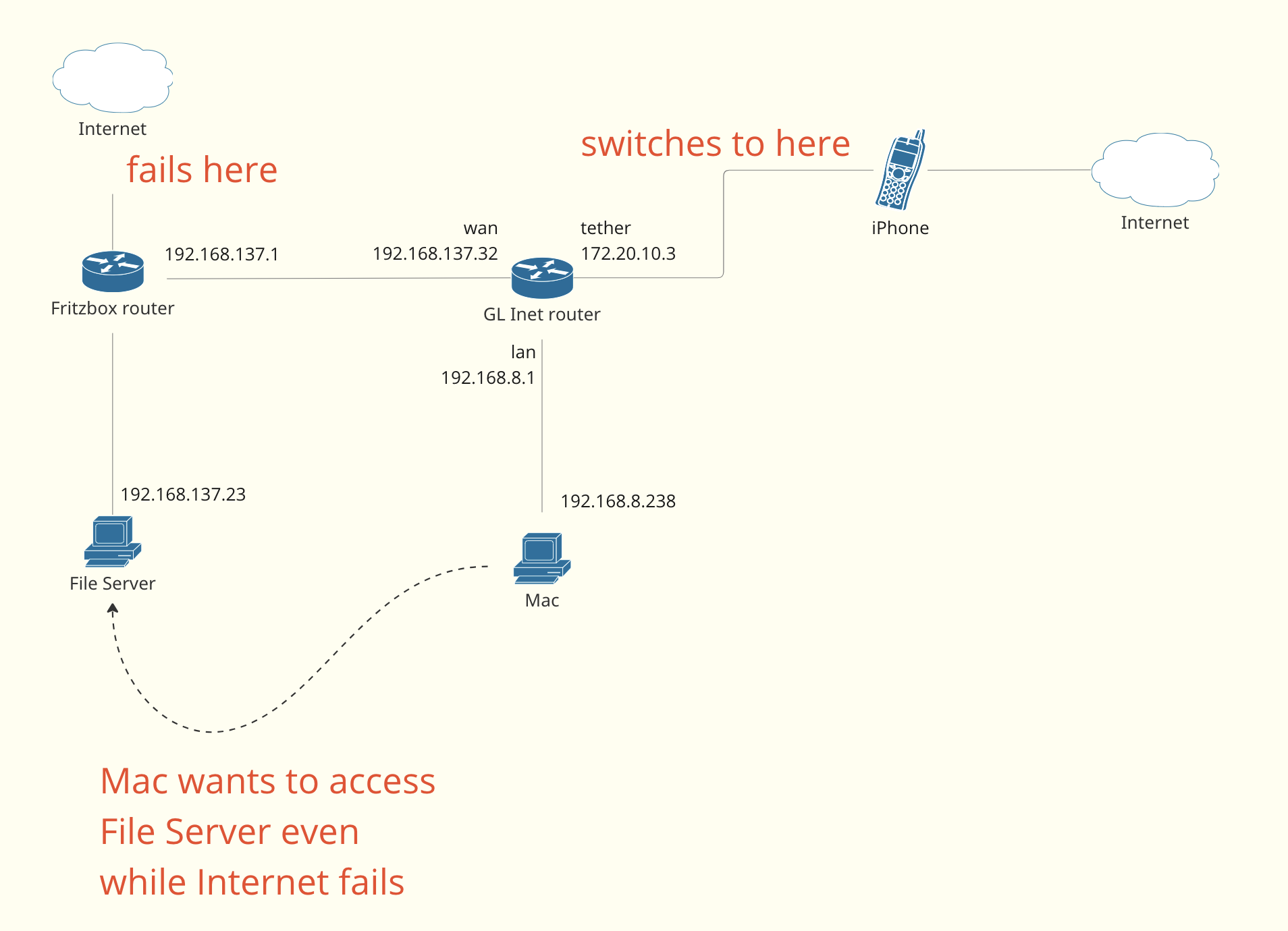

Because I am mostly too stupid for imagine how the setup looks like, could you draw it using draw.io maybe?
Make sure to include the IPs for each router (and modem) as well.
Thank you!
Looks like this:
