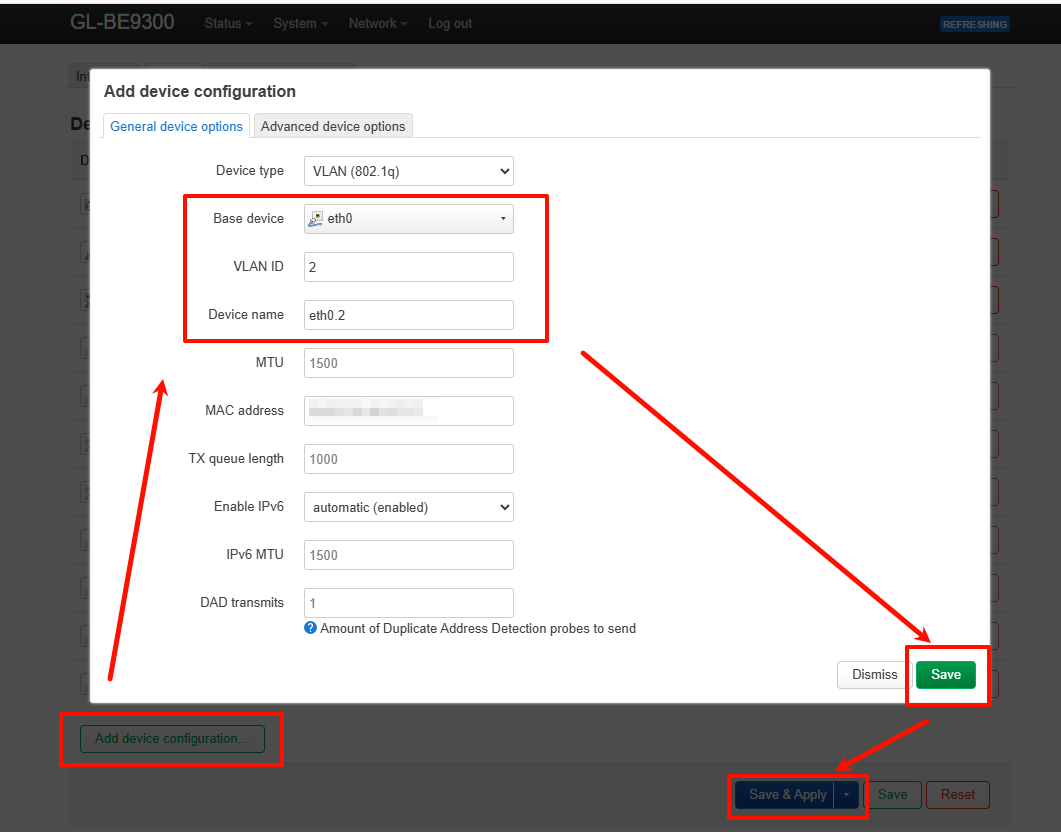

You will need to add one device per VLAN using Luci and then one interface for each device.
I have two VLANs for m service: Internet and IPTV and everything was done in Luci.

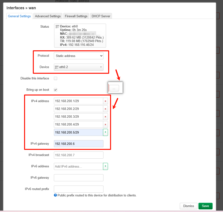

Based on your description, it seems you only need to configure VLAN 2 to communicate with the ISP modem.
If so, we can directly create a VLAN ID 2 interface based on eth0 in Luci - Network - Interfaces - Devices tab.
Then, in the Interfaces tab:

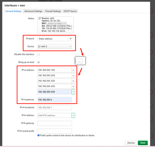

  • Switch the WAN interface device to eth0.2
  • Switch the protocol to Static Address Mode
  • Add the 5 IP addresses you possess
  • Configure the gateway address
