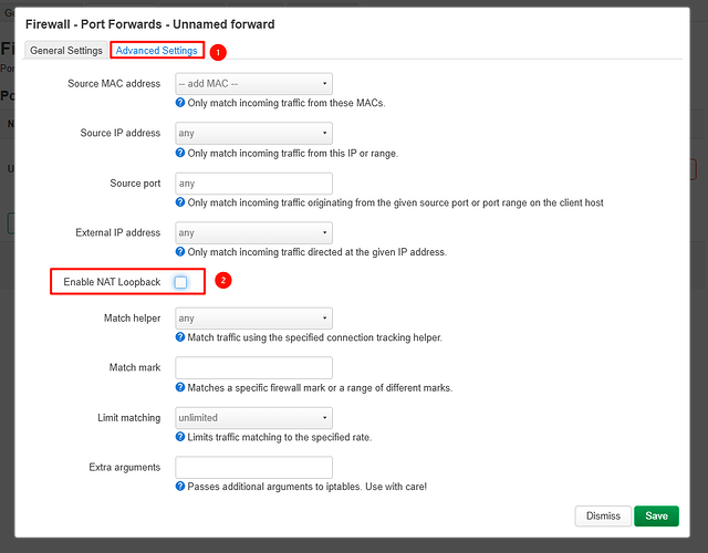

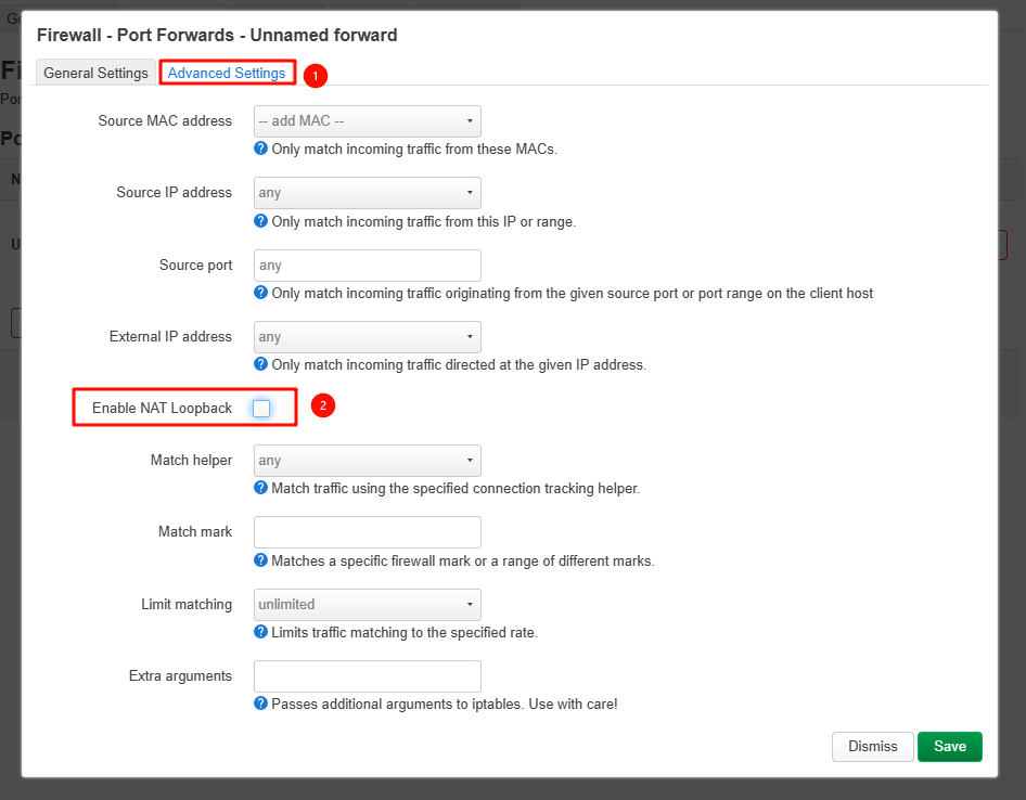

Please navigate to Luci - Network - Firewall - Port Forwards and edit the corresponding port forwarding rule to disable the "Enable NAT Loopback" feature.
I disabled NAT loopback for all of my port forwards and my qnap is still showing all addressing as coming from the gateway. I attempted to log in from different devices and on different networks. All of it was showing the same gateway address as the access location. I did not have this issue when I was using my dd-wrt router before on this NAS. Are there any other settings I can look at?

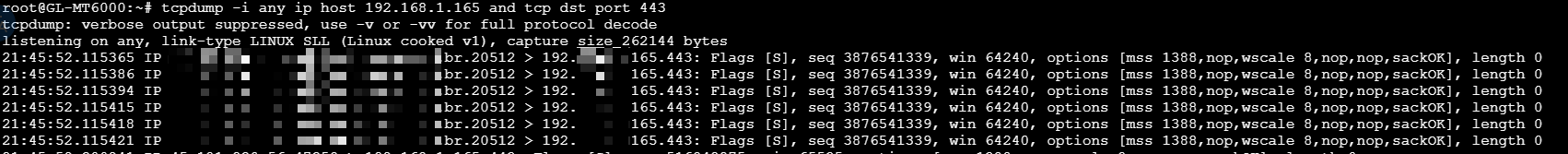

Please also SSH into the router and run the following command to check whether any SNAT or MASQUERADE rules are present:
iptables-save | grep -e 'SNAT' -e 'MASQUERADE'

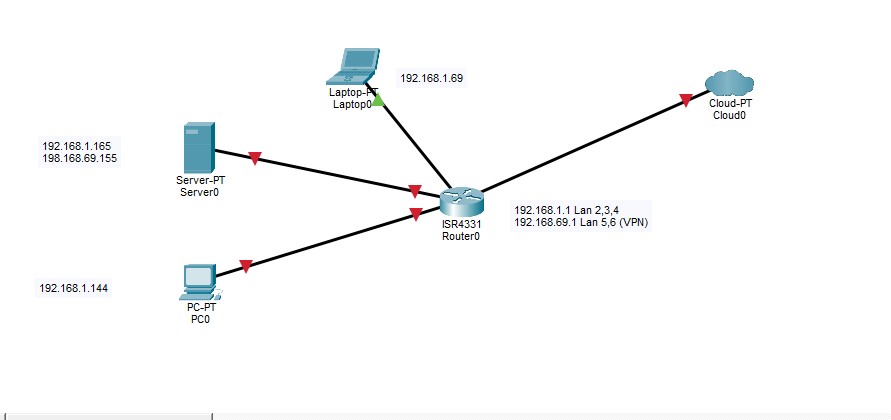

Here is a simple drawing of the local network. When I disabled NAT on my network, it broke outside connection to the server. I have a reverse proxy set up on the server to go from the http to https when connections hit the http outside my network. This did not effect my previous router. I dont have access to the SSH into it now and the option to message your chat is not available because it says you are private.
In summary, without NAT on, the connection to the server breaks, including from the qlink software connection provided by qnap. With NAT on, I am still unable to get outside addresses delivered to my router with their source IPs but I am able to access the router.
The external traffic is all going through the 192.168.1.0 network

  1. The port forwarding rules did not appear to be configured as suggected. Therefore, we have disabled the 'Enable NAT Loopback' feature.

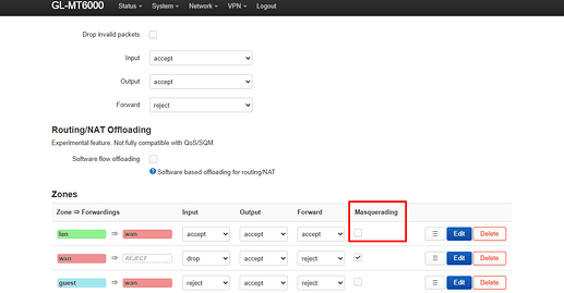

  2. Masquerading in the LAN firewall zone was mistakenly enabled, so we disabled it as well.
It should now work as expected. Please double check.
