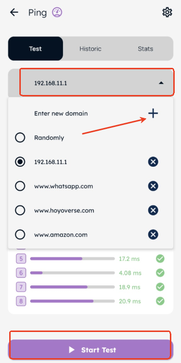

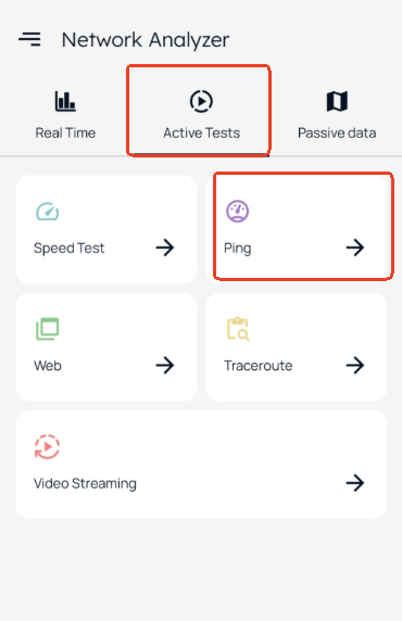

Anyways, can I do the ping test with an iPhone and Android connected to the WiFi network? If so, how?
You can select the text in my post and click Quote \ copy Quote , or click the link icon below the post to copy its link and paste it into the reply box.
For the ping test, install the Network Analyzer app on both phones.
Open Ping , enter the other phone’s local IP address, and start the test.
