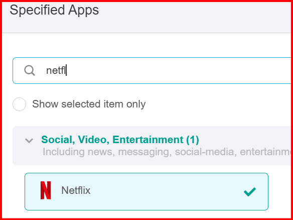

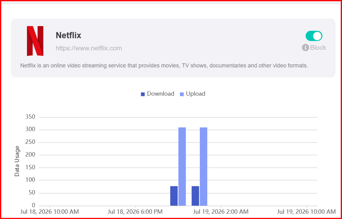

Blocked under Streaming services?
Blocked under content filter?
Blocked under traffic stats?
(I do not use Netflix that is why all my images show NF as being blocked.)
