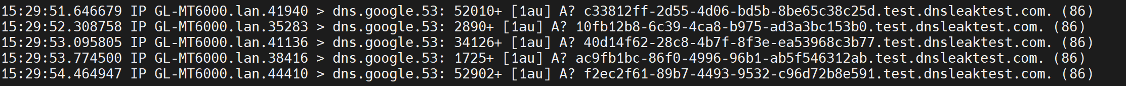

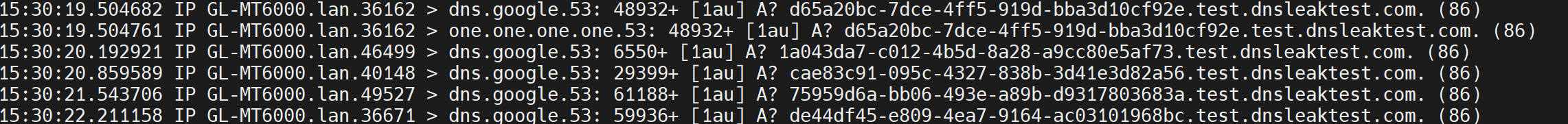

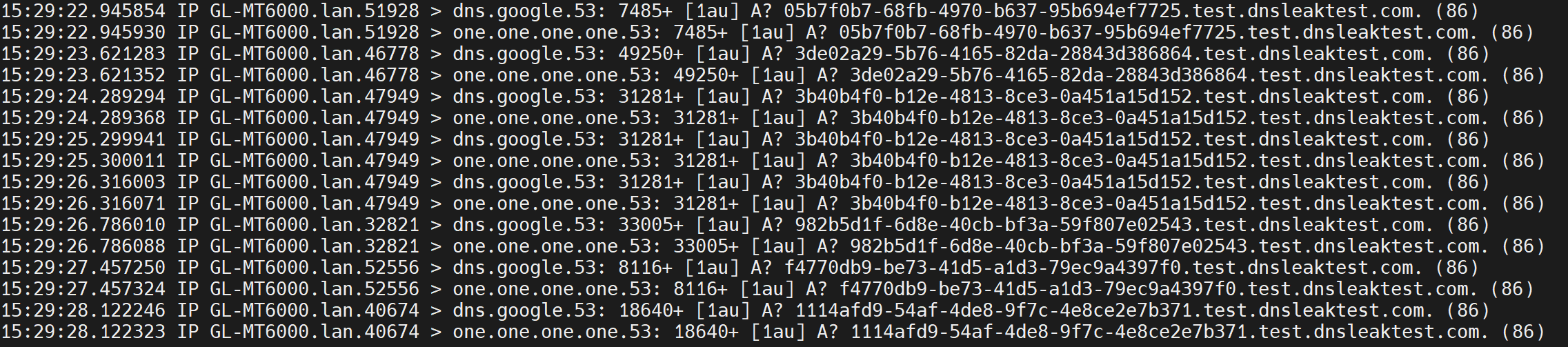

As it stands, I just ran a basic test and with default FLINT 2 setup, both servers are being queried, which is not the desired process outlined above. How to force strict sequential DNS Server use?

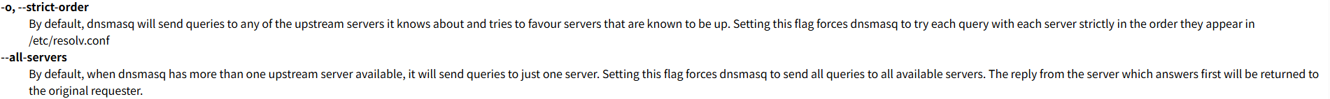

Please also refer to the dnsmasq documentation:
By default, when multiple upstream DNS servers are configured, dnsmasq continuously evaluates the availability of all of them and preferentially uses the server that responds the fastest for subsequent queries.
You can change this behavior using one of the following options:
  1. -o, --strict-order (this matches the behavior you are looking for)
uci set dhcp.@dnsmasq[0].strictorder='1'
uci commit dhcp
/etc/init.d/dnsmasq restart
  1. --all-servers
uci set dhcp.@dnsmasq[0].allservers='1'
uci commit dhcp
