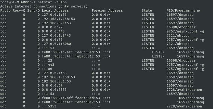

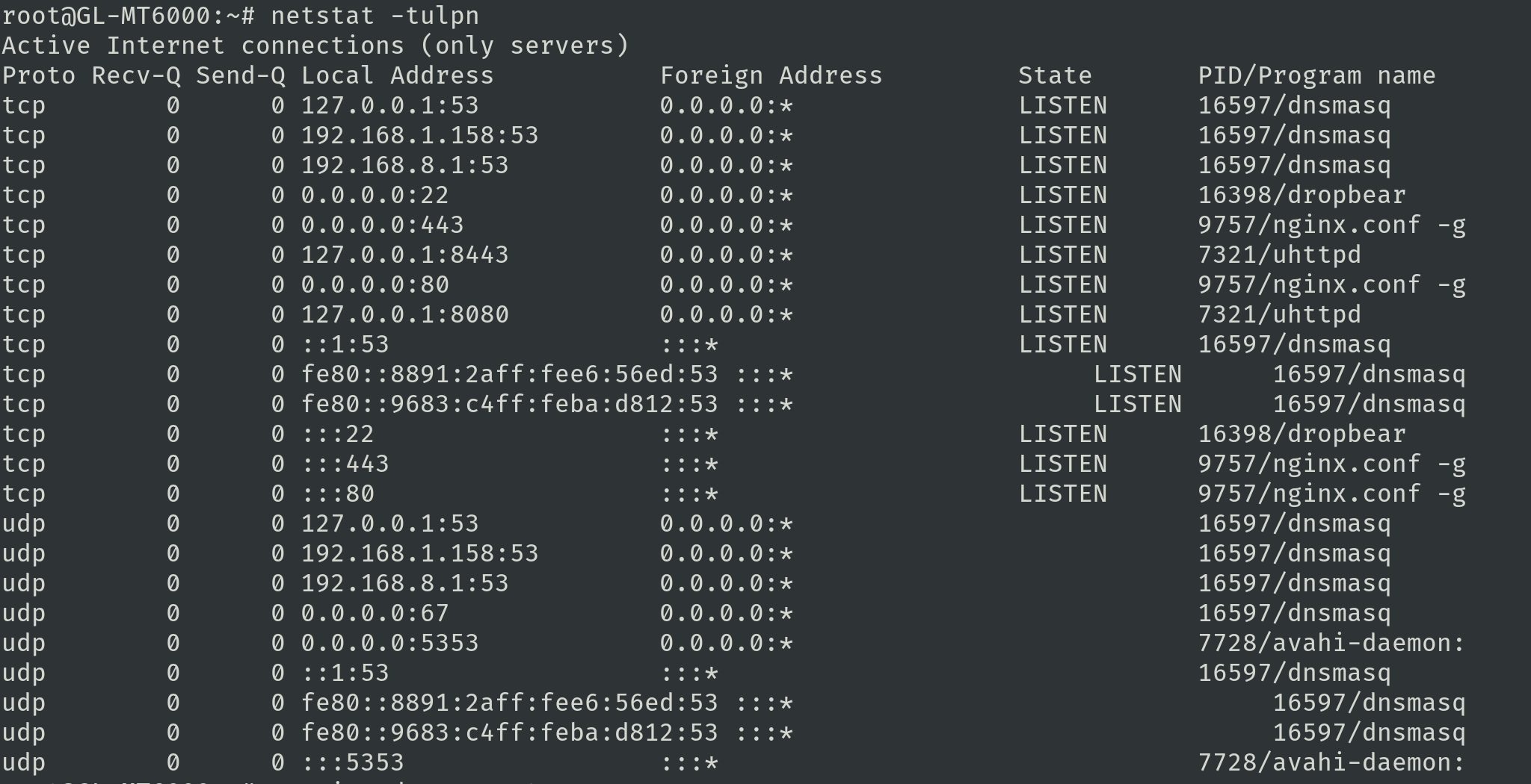

Before disabling dnsmasq, this is netstat output:

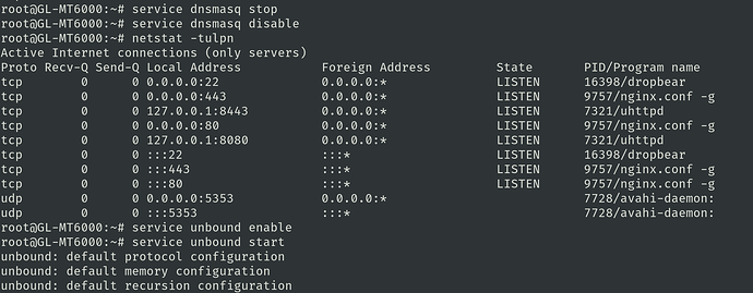

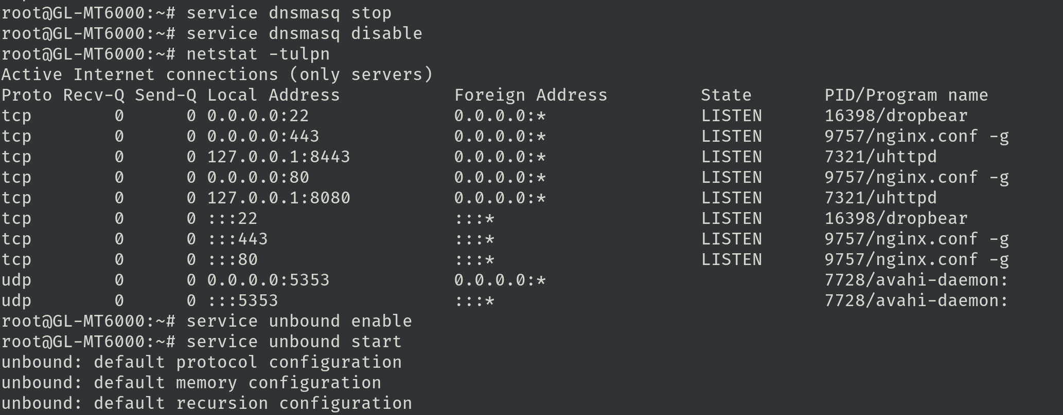

Then I run service dnsmasq stop and service dnsmasq disable to disable the dnsmasq, here is the netstat output after:

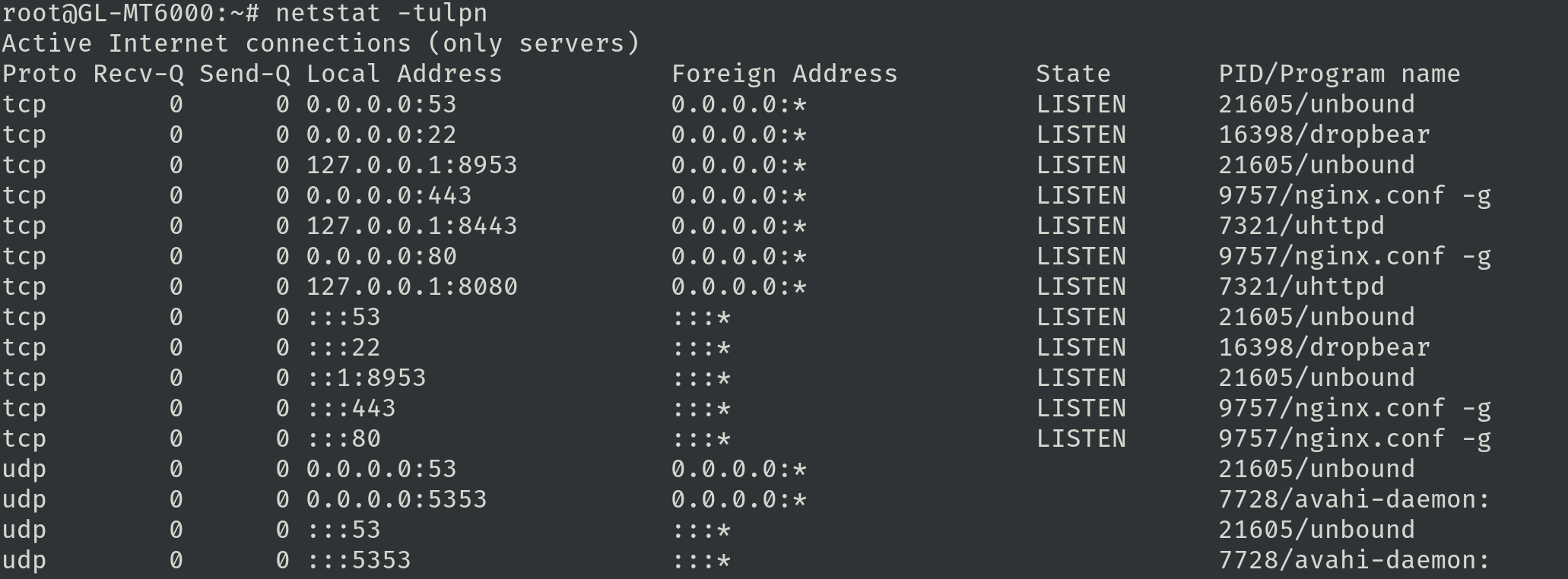

I then run service unbound enabled and service unbound start, and netstat:
I think unbound is reached since I saw the output from unbound-control dump_cache (I enabled unbound-control and service unbound restart).
