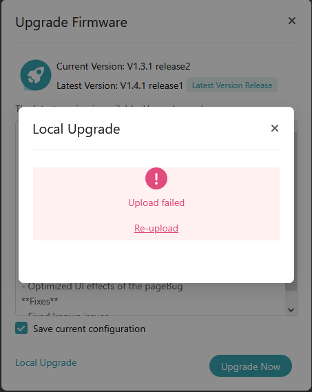

I tried to apply the latest firmware and never kicks off the download package, so I attempted to do local upgrades. That will not just gives an :"Upload failed" "re-upload" error. I tried 1.4.1, 1.4.0Beta, 1.3.1 images and all the same issue. I am currently running v1.3.1r1.
Is there a way to kick off the upgrade from a web terminal?
Thanks.
reset default OR try to remove big file from /userdata llike /userdata/core*
Hi minmie!
That looks like that did the job for me and I am able to upload. Thank you for the quick respond. Hopefully, newer version will have that option to clean up older files to allow upgrades. This is the best KVM over IP that I have owned, which includes PiKVM and JetKVM. Already in the queue for the Comet Pro.
