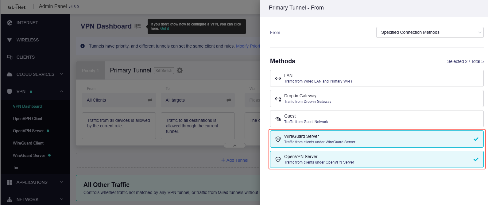

If enable "AdGuard Home Handle Client Requests", all client DNS will hand by ADG.
It changes the configure method:
tick the WG server or OVPN server, that will let the traffic from server and go to client
Yes, but the upstream dns server adguardhome should use, can only be reach via vpn, which does not work with v4.8.0
