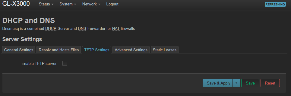

I did a factory reset and updated my GL-X3000 to the newest firmware.
Everything seems to work well so far except I noticed this weird glitch in the Web UI:

I see this too! but only two panels, not the 4 that you're seeing.
They seem to hold entirely different settings as well i.e. changing a setting in one level doesn't change the setting in the other.
