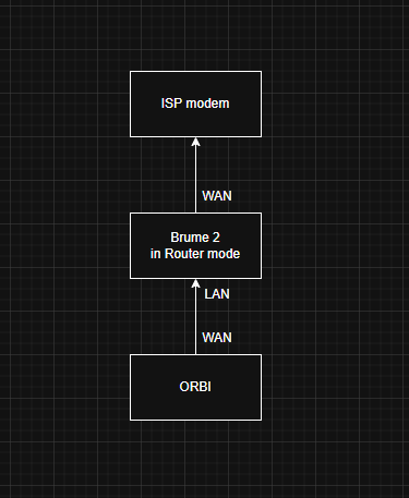

As you are new to router/VPN server configuration, we recommend connecting the Brume 2 between your ISP modem and the Orbi.
Afterwards:
  1. Configure port forwarding or DMZ on your ISP modem for Brume 2. This is for opening the OpenVPN server port to public netowrk.
  2. Set the Orbi to AP mode to avoid double NAT and VPN routing issues.
For information on setting up the OpenVPN server on Brume 2, please refer to Set up OpenVPN server - GL.iNet Router Docs 4.

Does your ISP modem provide an IP address via DHCP? If your connection requires PPPoE dial-up or specific VLAN tags, you can refer to the following configuration tutorials:
It is also fine to use the Brume 2 as a secondary router. However, for VPN server to work, you must configure Port Forwarding on whichever device holds the Public IP address, directing traffic to the Brume 2.
You can check the WAN Status page on both your ISP modem and your Orbi router to find who have the Public IP address and then:
  • Scenario A (Modem in Bridge mode): The Orbi gets the Public IP. You must forward the VPN port from the Orbi to the Brume 2.
  • Scenario B (Modem in Router mode): The Modem has the Public IP. You must forward the port from the Modem to the Orbi (or put the Orbi in the Modem's DMZ), and then from the Orbi to the Brume 2.
