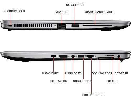

This is the laptop I have with the ports. Thank you!
Thank you for getting back! Now that is a good question. Not sure how to test if it is full-function port. I did order these Amazon.com: Warrky 4K DisplayPort to HDMI Cable Adapter 6FT 2 Pack, [Aluminum Shell, Nylon Braided] High Speed (1440P 60Hz, 1080P 120Hz) Uni-Directional DP to HDMI Cord Compatible for Dell, HP, Insignia, Samsung : Electronics - display port to HDMI. I hope they work. Or do you suggest any other cords?

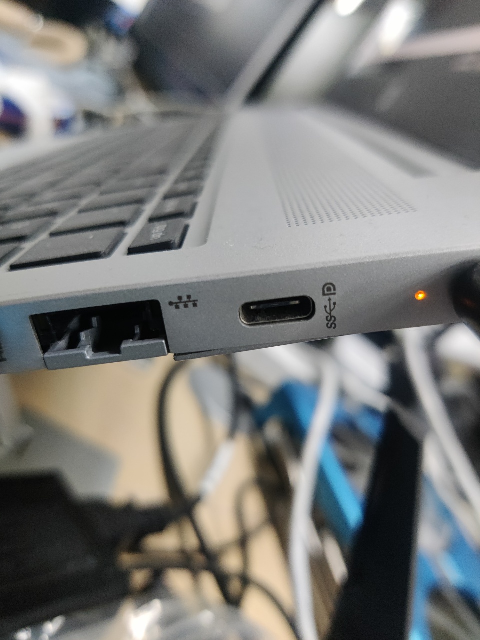

This is the full-featured Type-C port on my laptop. You can see it has a DP logo on it. In fact, the Type-C to HDMI adapter essentially communicates with the computer via the DP protocol. I noticed that the Type-C port on your laptop doesn’t have logos for DP, Thunderbolt, or other interfaces, so I guess it probably won’t work.
