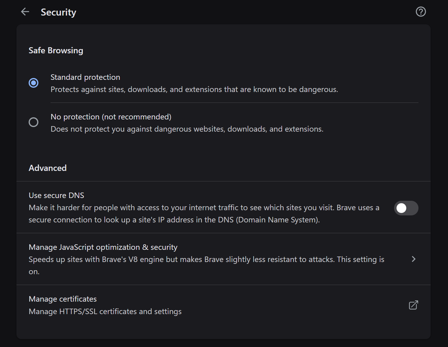

My computer browser secure DNS setting:
Neither the Brume2 or my computer is using encrypted DNS

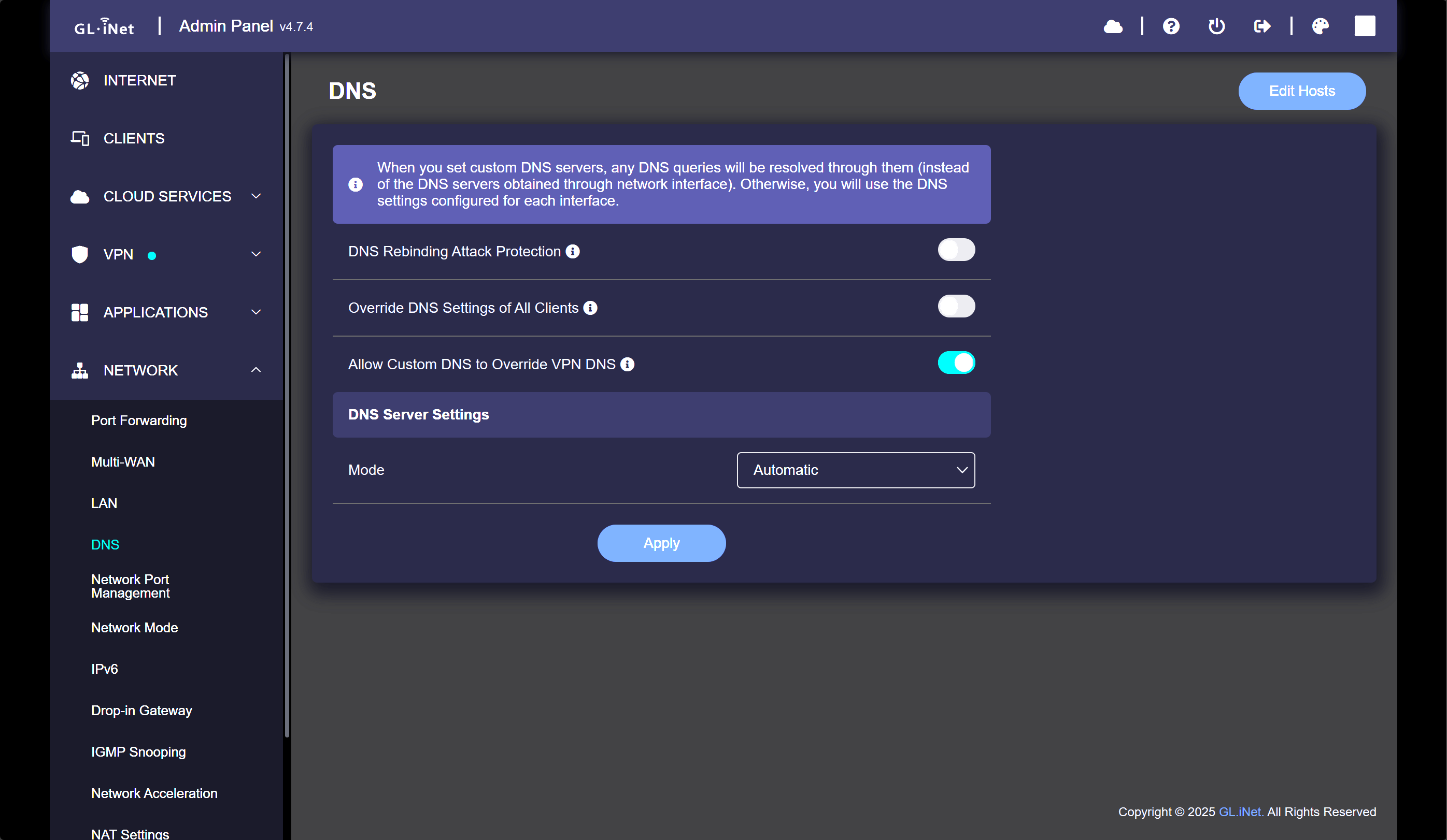

Brume2 DNS:
What about your browser?
