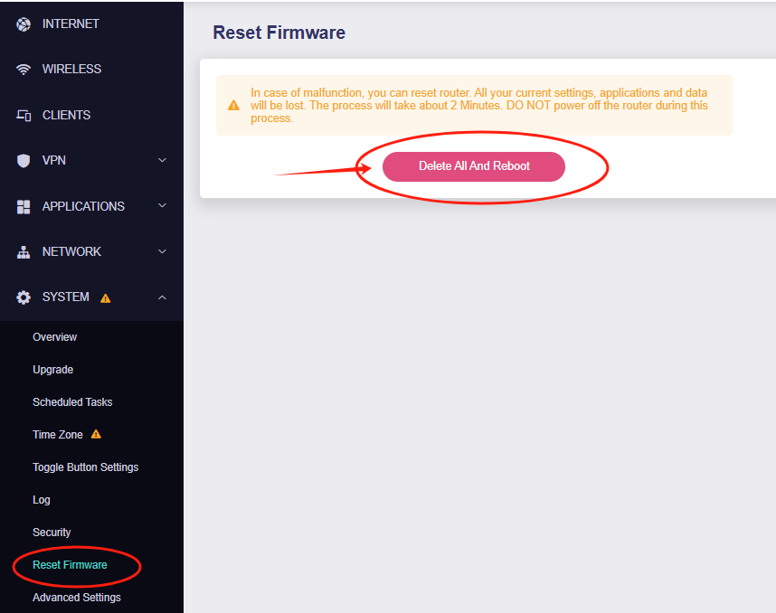

If you can't access it, try clearing the router's configuration and restarting it.
