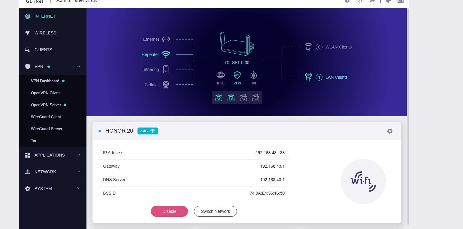

I would like to use the VPN router as follows:
Use my phone 1 to share a Wi-Fi connection, connect the VPN to the OPN VPN router.
I do the configuration explained in your tutorial
  • I export the configuration but and I try to put it in my other Phone 2 to connect the vpn but I do not get the tunnel

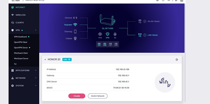

The SFT1200 in the screenshot is used as an OpenVPN server, right?
First as a VPN server, the router WAN needs to have a public IP.
Then refer to this docs to check your VPN connection:
