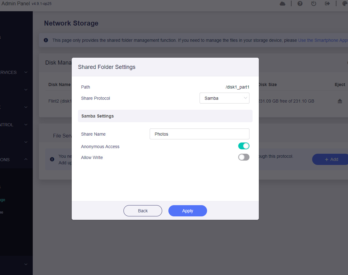

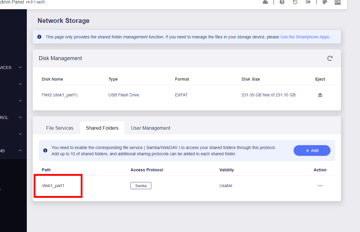

Hello! In your shares, i can see the different paths names from the two folders. But in my router, i set “Photos” as my first share name, but in the path, you can see that does not assume the “Photos” name, only shows me /disk1_part1. The path should be /disk1_part1/Photos, right? I already did a factory reset but it stays the same. Am i doing something wrong…? thank you

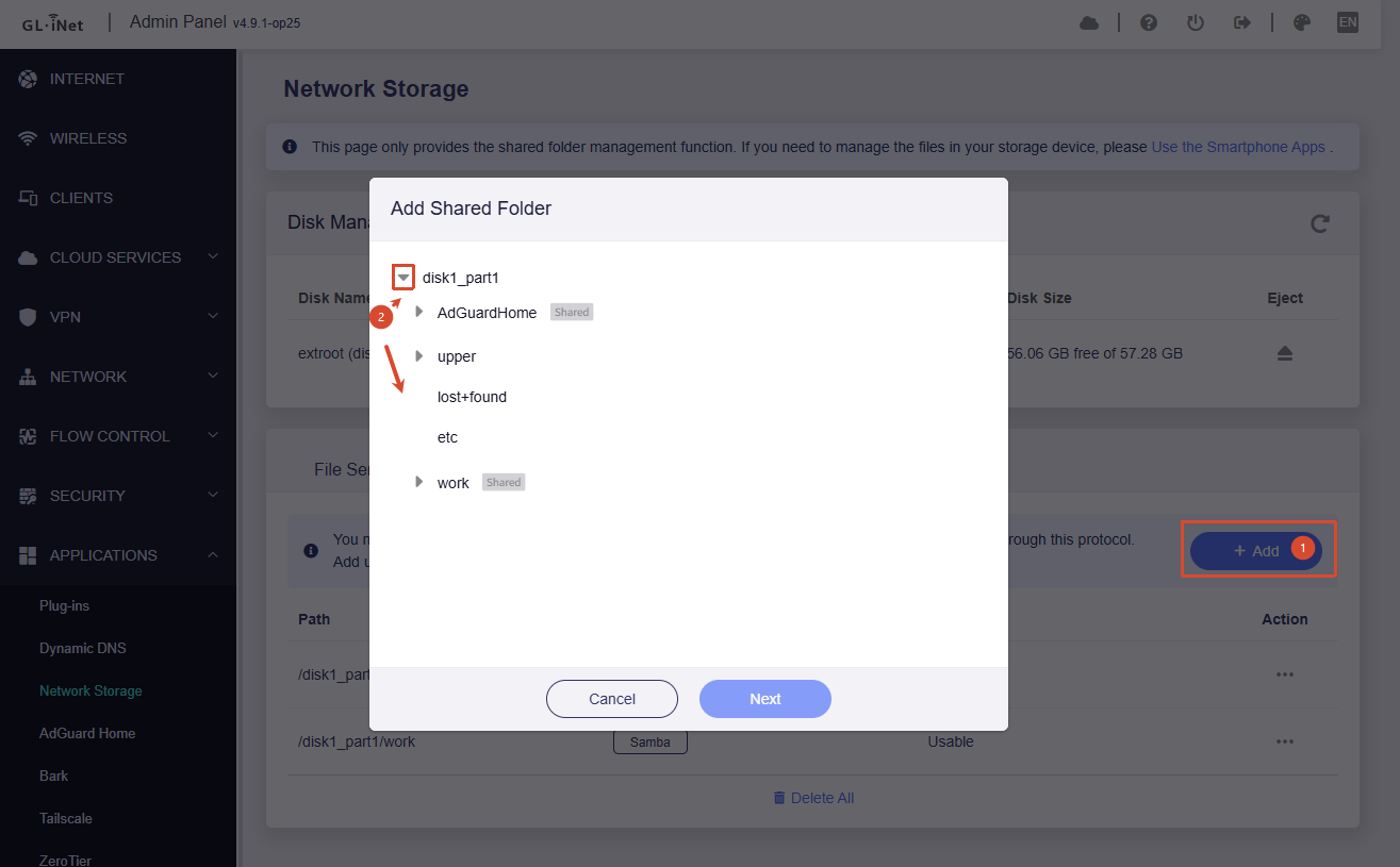

After clicking the Add button, we can select the specific folder path to share on the first screen:
Docs: Network Storage - GL.iNet Router Docs 4

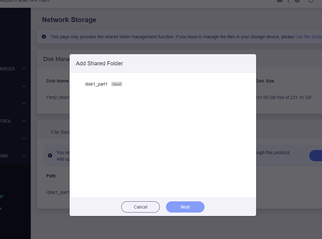

Hello, i don’t have that option to expand the tree folder
This seems a bit unusual.
There are indeed different folders on your USB drive, correct?
Please SSH into the device and run the following command to check whether the device can correctly detect the folders under the path:
ls -al /tmp/mountd/disk1_part1/
If the folders are detected correctly, please try using a different browser or an incognito/private browsing mode and check again.

I manage to solve it by creating the folders first in Windows, now i can share the 3 folders with Samba. Well, I don’t know if i’m just being stupid but i think that in 4.9.0 OP24, i haven’t manually created the folders first in my operating system. It was all done in router and when i typed the share name of my choice, the folder was created. Sorry if i wasted your time, thank you very much.
