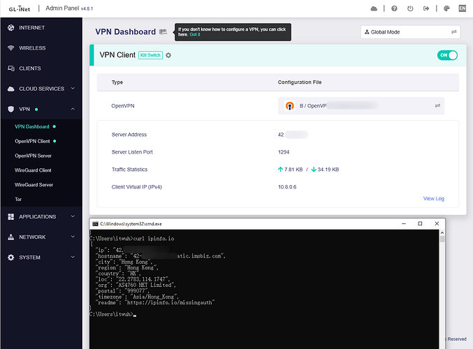

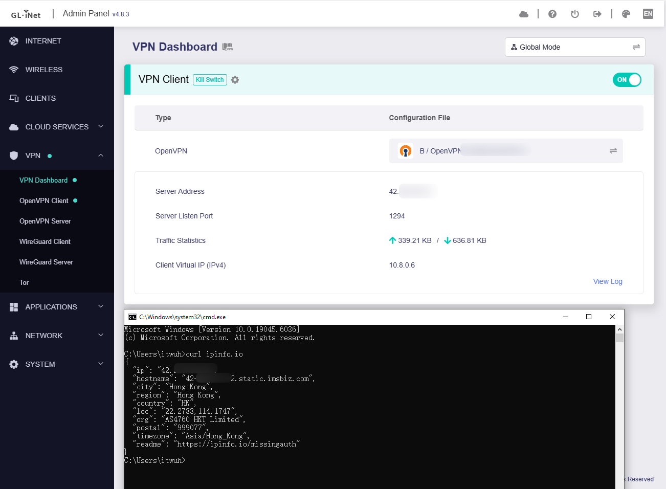

I did not reproduce to your issue locally, the MT3000 OpenVPN client connection is fine, tested on firmware v4.8.1 stable and v4.8.3 snapshot:
Please let me know your VPN provider, or please share your MT3000 router with us through the GoodCloud, and PM me the router MAC address and Admin Panel Password.
