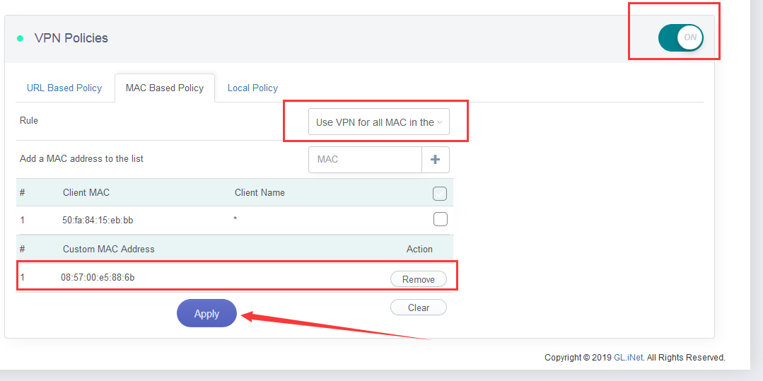

I upgraded my firmware to the policy routing testing firmware, but I still can’t get it to work, I get no internet connection with the routing policy setup. I’ve set it up so all MAC in list goes through the VPN. I’ve only added the one MAC for testing. It has no internet connection.
Do I need to follow a process to get it working? I’ve tried a few different ways, setting then rebooting, connecting to VPN first then enabling policy routing and vice versa.
Also, I assume that when policy routing is enabled, any MAC not in the list will do the opposite to what is set in the policy routing (All MAC through VPN or No MAC through VPN) and not just deny connection.
I have an example of a setup here. In this example, only 08:57:00: e5:88:6b is allowed through the VPN, and all other devices will bypass the VPN
Yep, that’s what I had. I had no internet connection for the device that should’ve been connecting through the VPN.

  1. I tried the firmware (750S) and tried to allow pass-thru (ie. non-VPN) for one MAC address and it didn’t work.
  2. Menu was confusing as to what was on the list and what wasn’t on the list.
  3. Allow VPN and disallow VPN options also very confusing.
I’m aware of the UI mess, which is currently improving. But the functionality should be normal, and perhaps, for now, the UI is hard to understand

I would suggest two lists:
First called ALLOW with option “block/disallow > apply”
Second list BLOCKED (or disallowed) with option “allow > apply”.
From my test it works, at least most of the time.
It is a little difficult to test. When you assign a domain from normal internet to vpn tunnel, or reverse way, use another browser or private tab to test. If you just use one browser and check ip location, it may report falsely.
