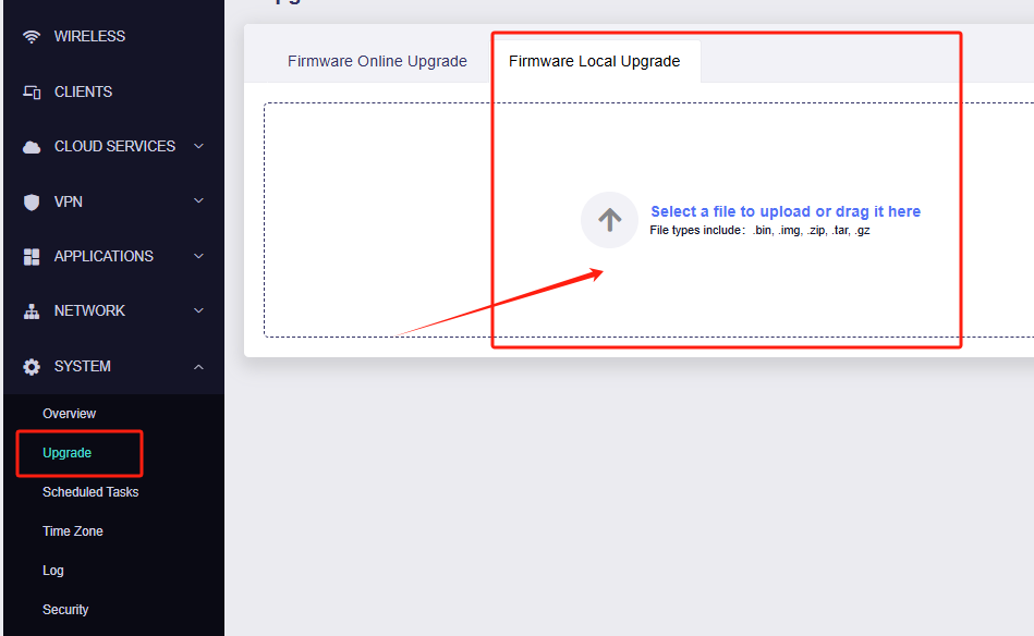

Sorry, did you upgrade the firmware using the local upgrade method on the router management page?

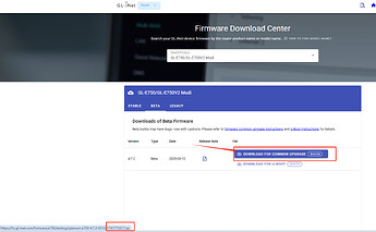

Perhaps you can double-check that the downloaded and uploaded firmware is correct.
If that doesn't work, you can also try reinstalling the beta firmware via U-Boot.
