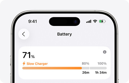

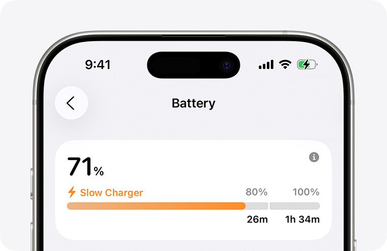

Apple introduced a new feature starting from iOS 18. When wired charging power is below 7.5 W (which happens to be the maximum USB output of the Slate 7), and you open Settings and tap Battery, it will show orange to indicate a “slow charging” state.
