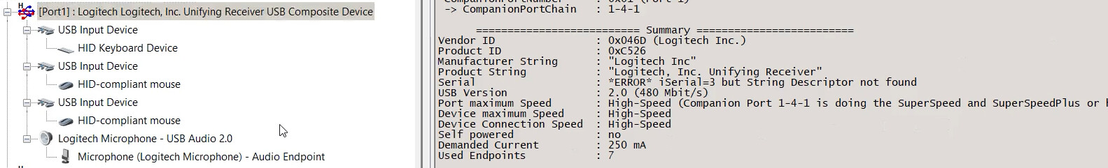

Not sure if this has been discussed, but picking the “Logitech Unifying Receiver for Keyboard” under custom device has the KVM present vid/pid of 046D/C526. Couple of issues that could cause someone to get flagged if Security wanted to get really tight:
  • Product string presented by GLKVM is “Logitech, Inc. Unifying Receiver”. It should simply be “Unifying Receiver”
  • Product ID presented by GLKVM is C526, which is “Nano Receiver”. “Unifying Receiver” should be C52B or C532
  • The logitech microphone device is placed under the Unifying / Nano receiver composite device, which is physically impossible. These receivers only support keyboard and mouse. GLKVM should present the logitech zone wireless unifying + audio receiver instead, which is probably 0A90, and the corresponding zone headset
Has anyone else noticed these discrepancies?

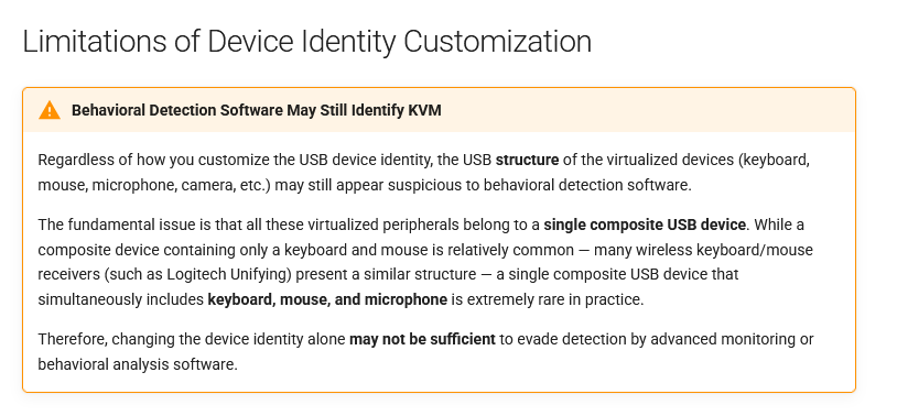

Out of curiosity, would it be possible to emulate a USB hub layout, with each device being connected to a port on the virtual hub? That way the PC sees a hub attached to its USB port with individual devices attached instead of a single composite devices.
There is no way to simulate a USB Hub.
In that case, the best approach is probably to emulate the unifying receiver + audio. That is the only plausible way a dongle composite device would have keyboard, mouse and a headset (microphone in our case)

This is not possible.
The problem is that the driver still needs to be signed, contains various metadata which is immutable telling it is a composite hub.
Having this dynamic would therefor force unsigned drivers breaking the chain of trust of the entire OS and then windows is not happy about this + that is a more red flag in security in their systems.
All fun that the name can be spoofed but this does not mean all the other things can.

It was detected immediately. I was online really late at night on a holiday trying to test it out and crowdstrike immediately sent me a notification and prevented me from accessing the internet etc.
