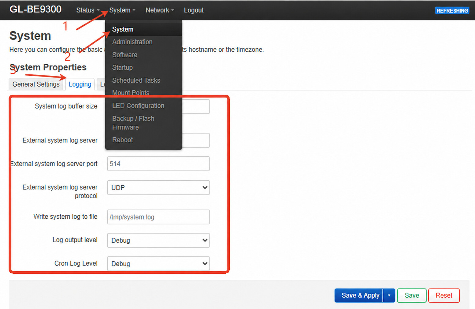

For system logs, Flint 3 can forward them to a remote OpenTelemetry Collector through Syslog.
Please go to LuCI → System → System → Logging, then configure the following options according to your OpenTelemetry Collector settings:
