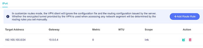

I also noticed this in the guide:
is that correct with the “link” as scope? the guide didnt say that in word actually I just saw the word link on the screenshots so I also used it. ignore the .4 btw in that screenshot.

I found this Accessing a subnet that is behind a WireGuard client using a site-to-site setup · GitHub which seems to be what I want to do, but I dont know whats difference to the above or how you can configure it with the GLInet GUI to work.

config route_rules ‘rule_5599’
option route_flag ‘4’
option dest ‘192.168.100.0’
option mask ‘24’
option gateway ‘10.0.0.4’
option scope ‘link’
