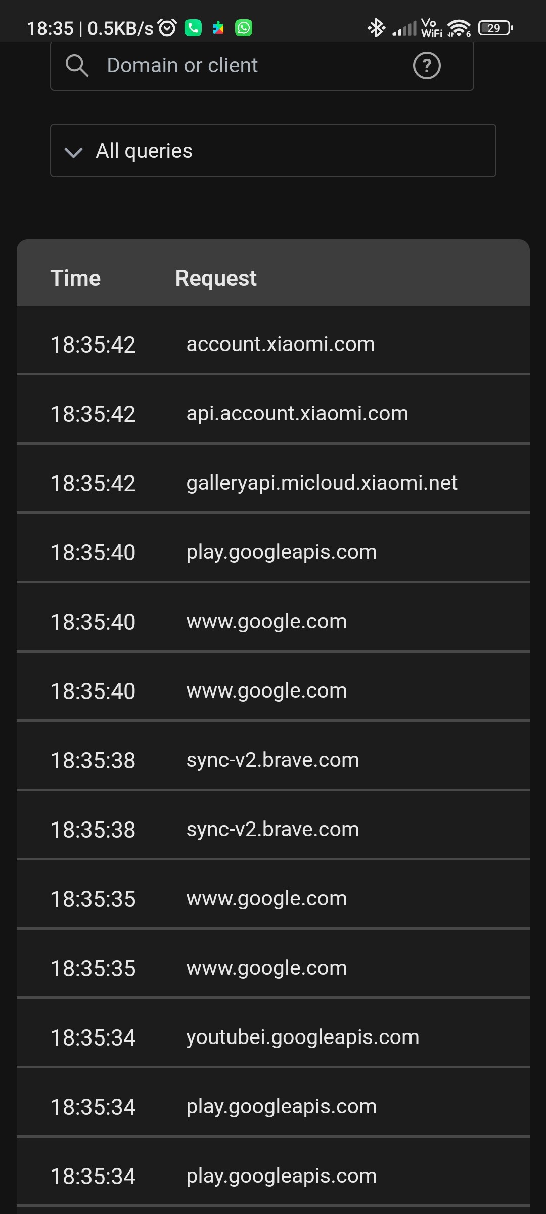

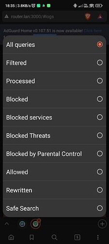

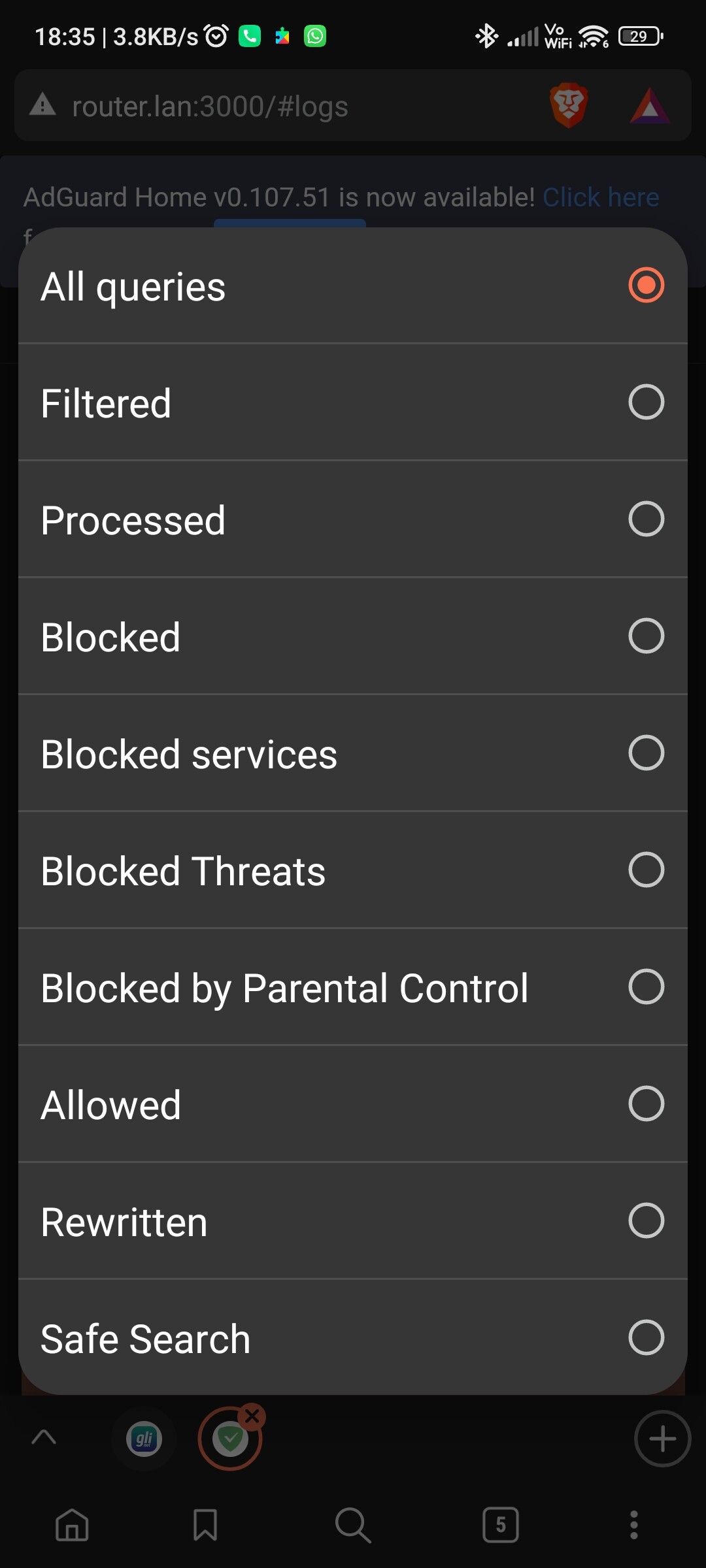

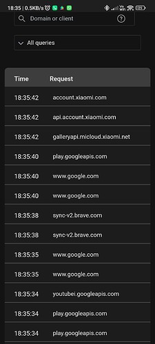

Go to adguard home > query logs
For mobile version:

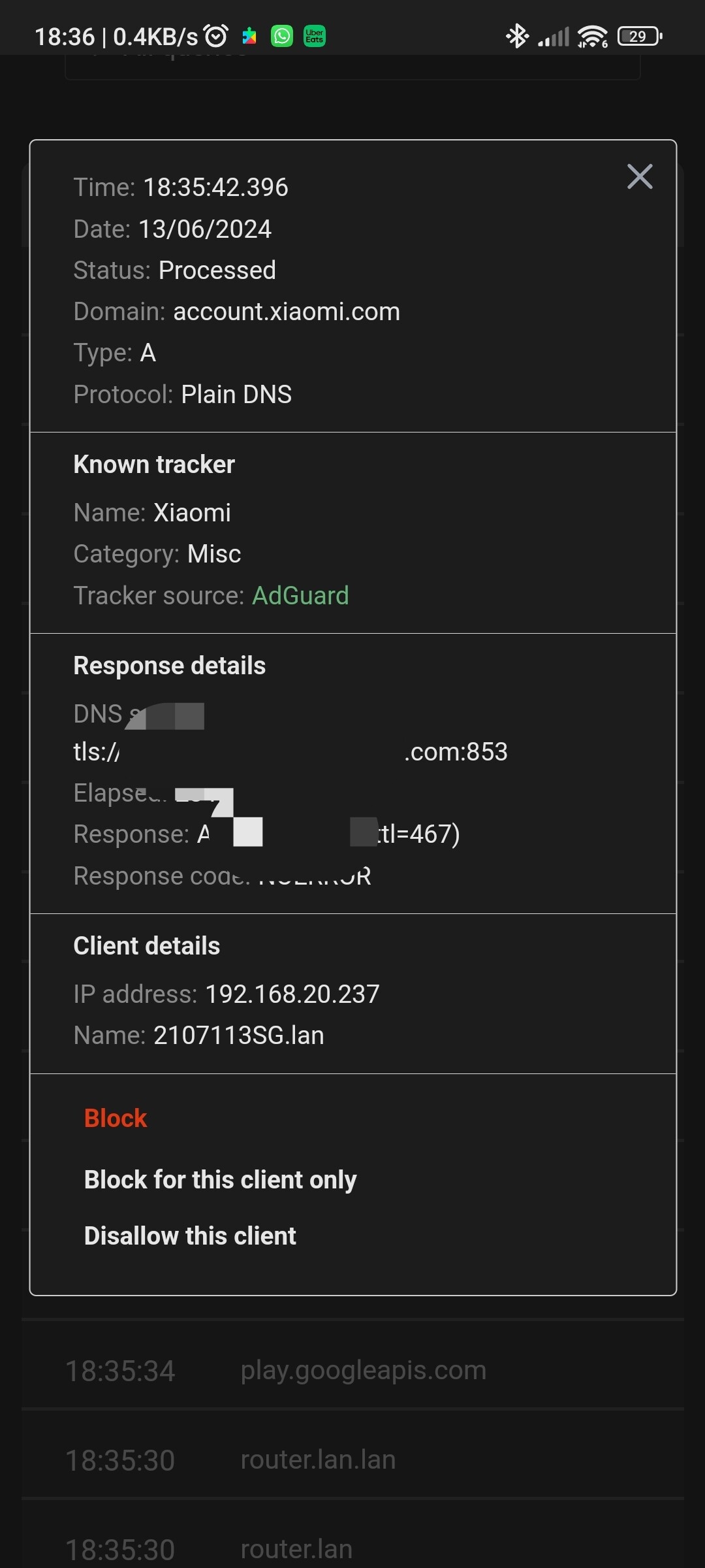

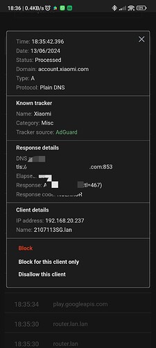

Click each domain and see full informations.
Decktop version more see tables.
