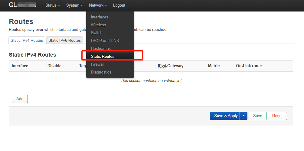

I would like to try option one but I dont know how to do this on the slate is there a easier routing plugin to use or will this require ssh? (I have never did this before)
Slate router can configure static routing through luci. Or via SSH.
I'm not sure if the upper router has a configuration GUI for static routing, but I'm sure you can configure static routing via SSH.
