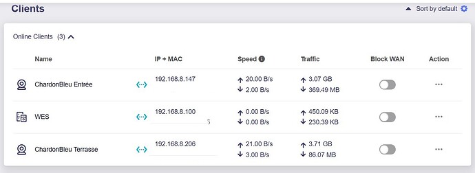

Note that : Mango (192.168.0.1) has 3 clients: 2 IP Reolink cameras and 1 Web Server. Access to cameras are OK. Access to web server is no longer working.

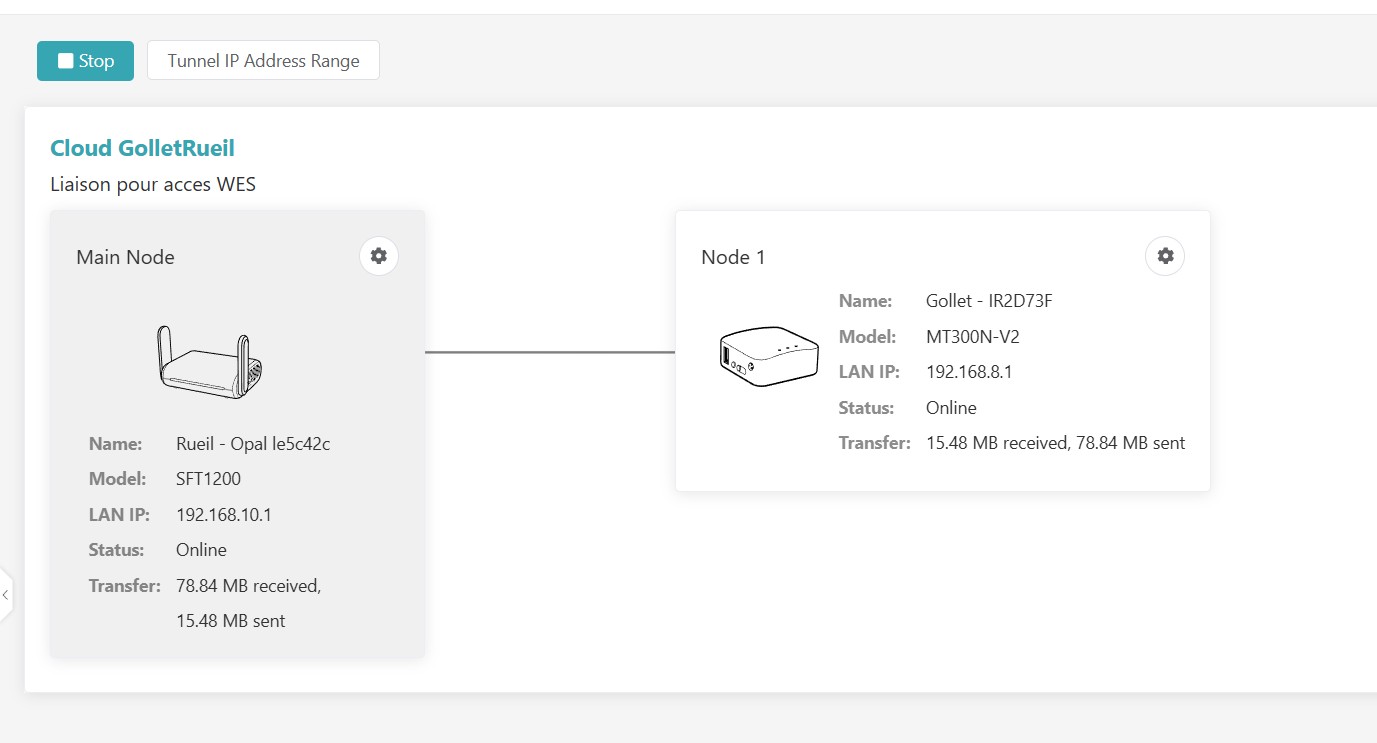

Attached is screenshot of GC site to site.
Thank you for providing the test results and the screenshot.
Since 192.168.8.1 and the two cameras connected to the Mango can still be accessed through the Site-to-Site network, the Site-to-Site tunnel and the basic routing between the two LANs appear to be working normally.

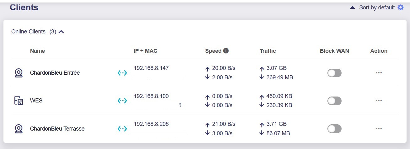

If usefull Mango clients …
