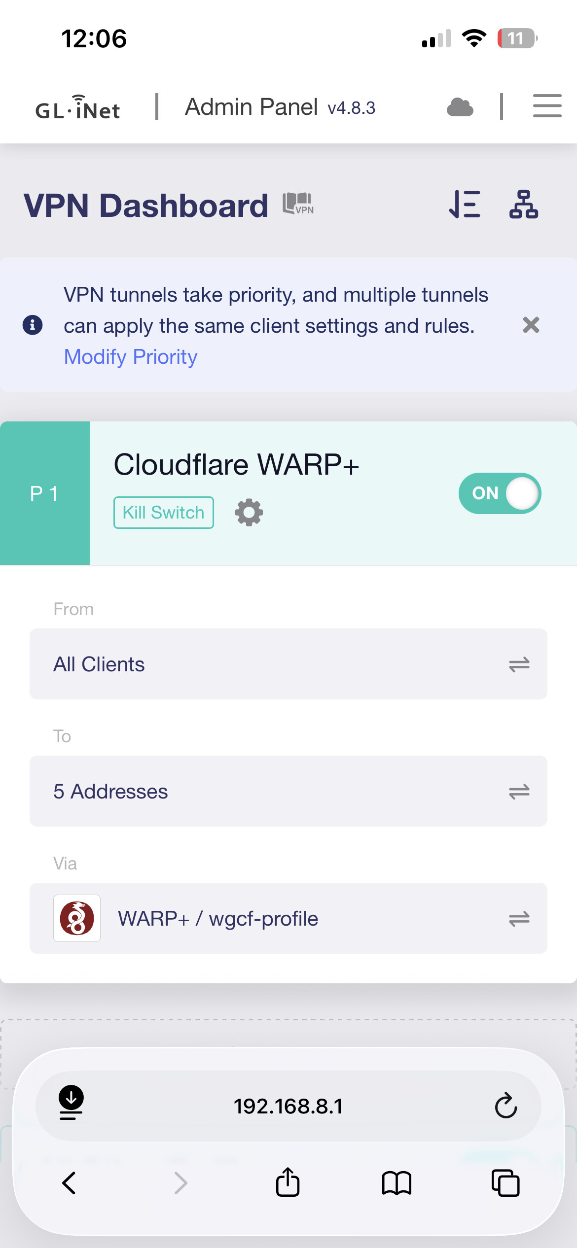

I am using Cloudflare WARP+ via WireGuard on my GL.iNet router (Firmware v4.8.3). I’ve encountered a very specific and strange issue related to Policy Mode:
The Problem:
•	When I use Global Mode, everything works perfectly. All sites load without any issues.
•	When I switch to Policy Mode, some adult sites like xh***.com still work fine, but others like p****.com and xv**.com appear “broken” (CSS doesn’t load, images and videos fail to appear).

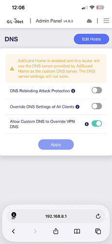

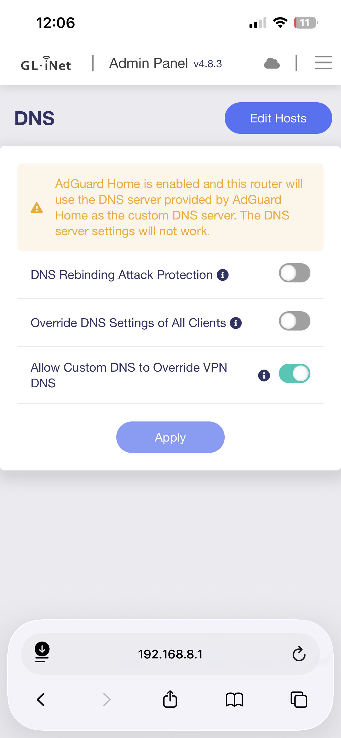

2.	AdGuard Home: Tried disabling it completely; no change.
3.	DNS: Tested with Cloudflare (1.1.1.1) and Google (8.8.8.8).

This is the expected behavior.
In policy mode, only traffic to the domains you have configured will be routed through the VPN.
If a service also uses additional domains/CDNs, you will need to add those related domains to the list as well.
Thanks, I add a other CDN address, fix it
