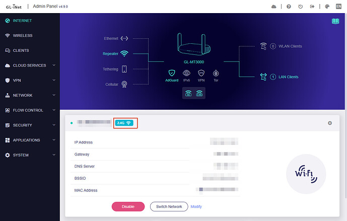

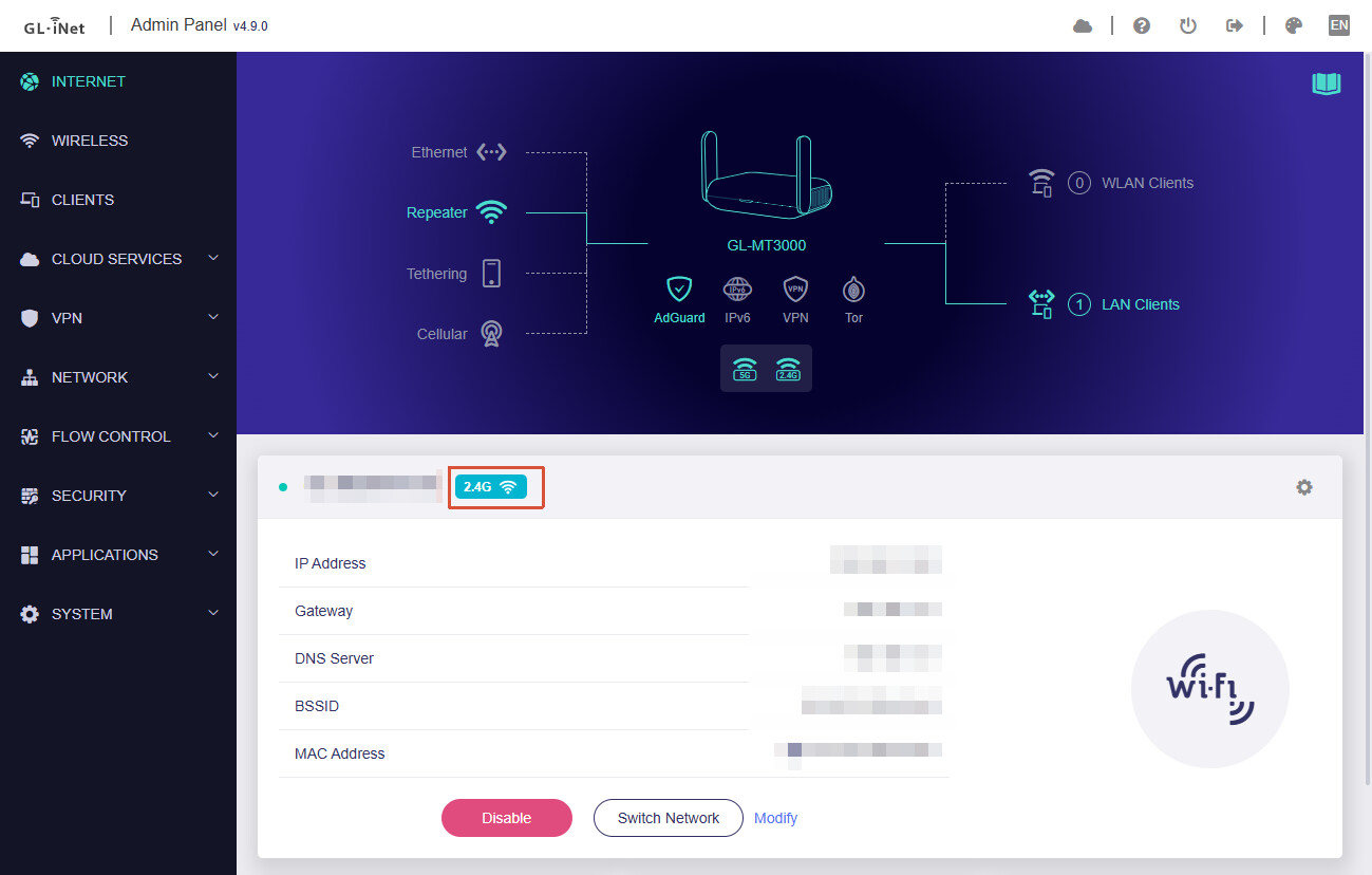

  1. Is the upstream SSID a combined dual-band network? If so, please make sure the MT3000 is connected via 5 GHz rather than 2.4 GHz. You can verify this under Admin Panel → Internet → Repeater:

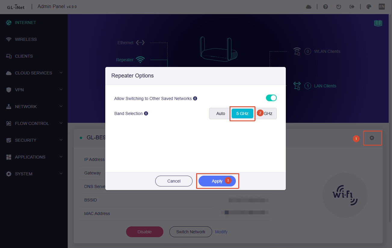

  2. If the MT3000 is connected to the 2.4 GHz band, you can try adjusting the settings below to force it to connect to the 5 GHz band instead:

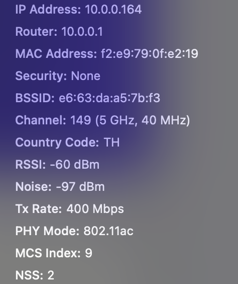

  • MacBook: Please refer to the following guide to check the current Wi-Fi link rate:
https://www.cyberciti.biz/faq/how-to-see-your-current-wi-fi-connection-speed-in-mac-os-x/
Upstream wifi is a dedicated 5ghz band.
Macbook:
Router:

The link rates look the same, but it looks like they are connecting to two different BSSID, and the beryl is getting a much worse signal quality from the access point it selected? Is there a way to try and force it to connect to the closer access point?
