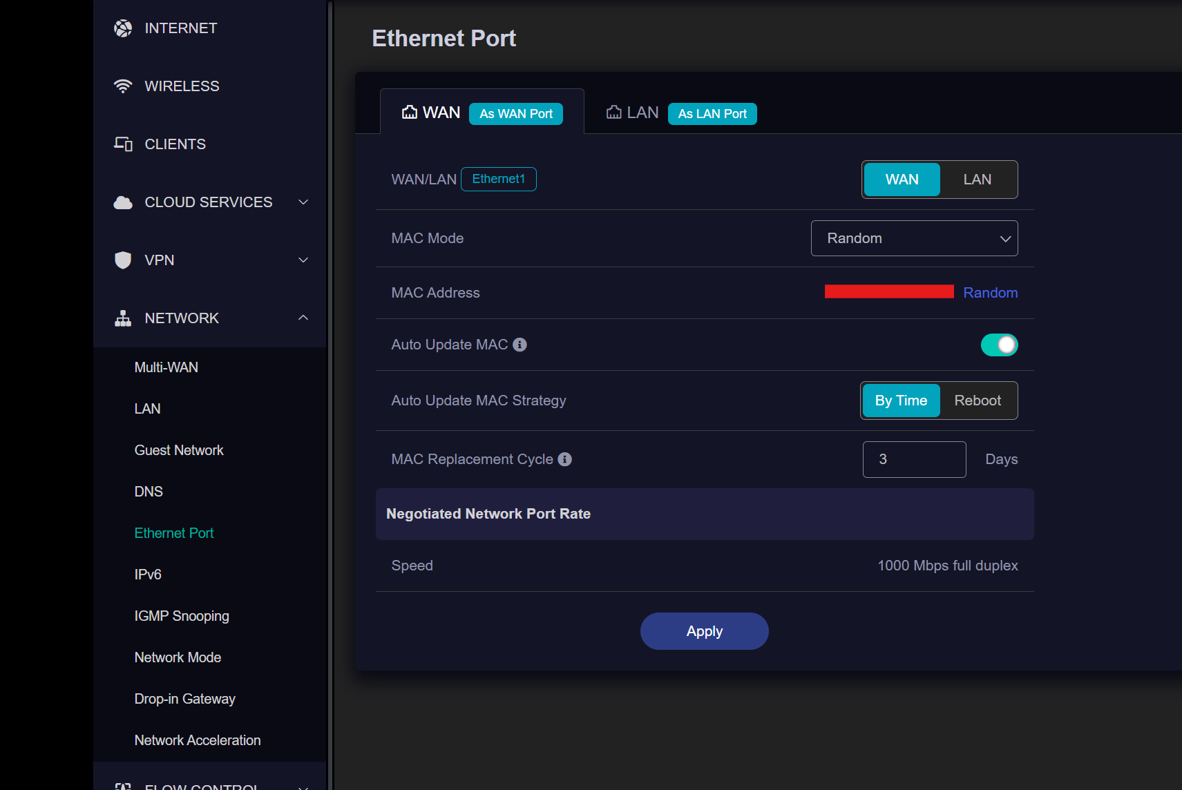

Or as i did have kinda same prob with PPPoE been stuck slow till i random changed my mac address that some how fixed it for me from been stuck slow, When you change mac address it will take 2 mins of trying to connect, After that it will connect to that address. im on slaf 7 pro v4.8.4 fw thought but did kinda have same prob with PPPoE now mines fine.

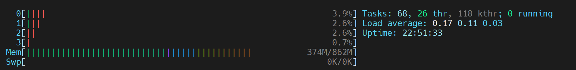

  2. Back on the Flint 2, when running a Speedtest from a LAN device, please SSH into the router and check the CPU usage:
    opkg update && opkg install htop
    htop
