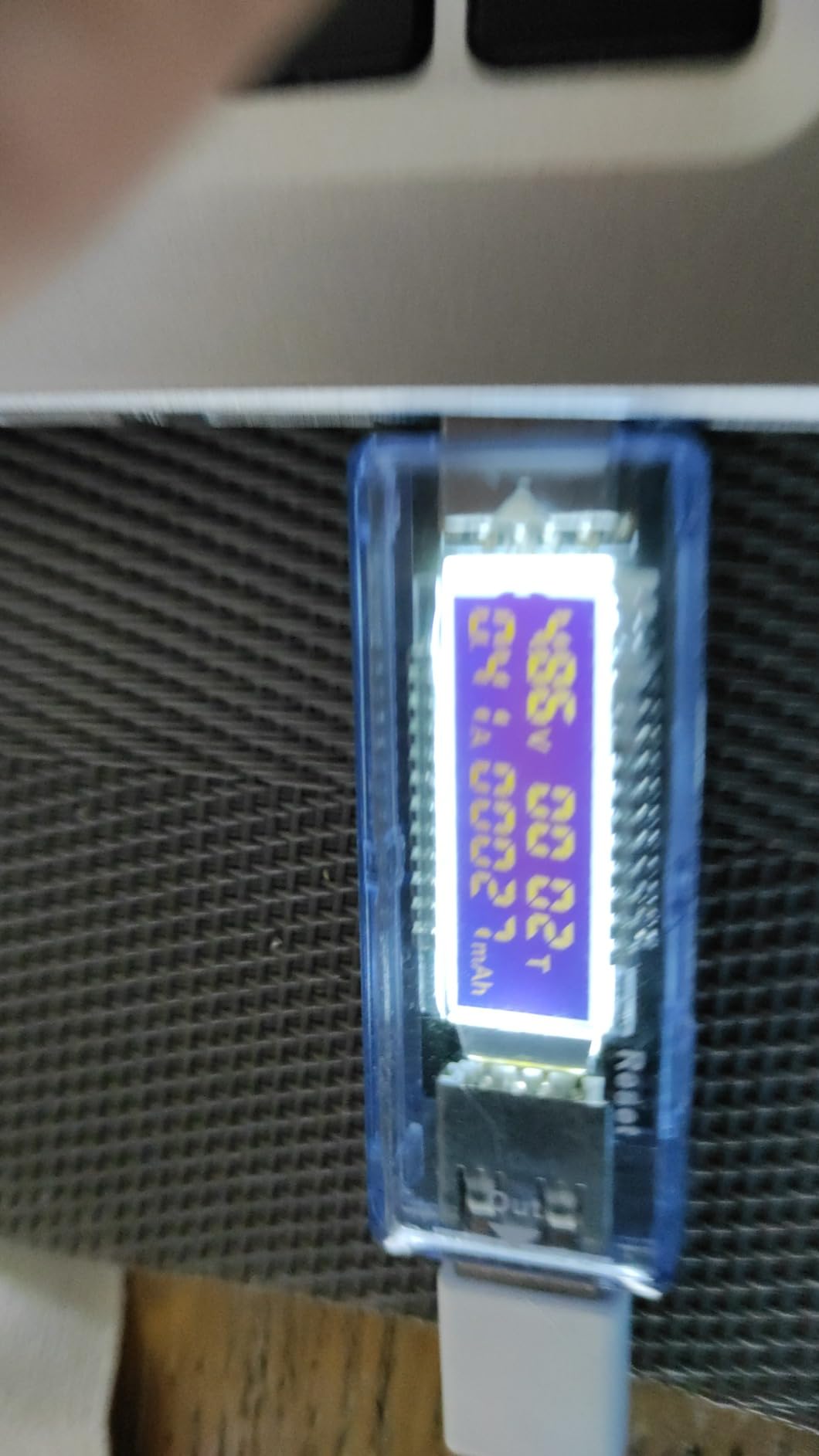

There are often comments on the need for using the strong original power adaptor. (5V/3A). However measuring the current via USB-C port power, when no extra USB device is attached to the SFT, indicates a low power consumption, and the 700mA of a laptop certainly can deliver that needed power.
The USB - C ports across certain laptops of different brands exhibit variable power - delivery capabilities. Some can supply current up to several thousand milliamperes, while others may lack a stable 5V output and provide less than 500 mA. Such inconsistent power provision fails to meet the operational power requirements of the SFT1200, potentially hindering its normal functionality.
