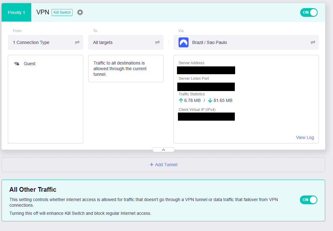

I'll show you my router scenario. I have the main network running normally and the guest network using only the VPN. See the image below as I'm using it.
Every week, I noticed my Slate 7 would crash, and all connected devices would no longer be able to access the internet. Even if I restarted the Slate 7 or turned it off, when I turned it back on, the internet wouldn't work. I realized I needed to go to the VPN Dashboard and click "(OFF)," then do the same for "All Other Traffic." After that, the internet only worked again when I followed this exact order: Enable (ON) the VPN first, then enable (ON) "All Other Traffic" so that all devices could browse the internet again. Shouldn't this happen automatically when I turn on the router?

Wouldn't a future firmware update fix the issue? It's a recent firmware, so I imagine it might have bugs. Another thing I didn't mention is that when the router loses internet and I need to reboot it, if I don't follow this process of disabling the VPN and all other traffic, and then enabling the VPN first and then all other traffic, my Google TV Streamer 4K won't connect to the router. This happens after the Slate 7 reboots. The network appears saved on the Google TV Streamer, but when I click to connect, I get an error message. The only solution after the Slate 7 reboots is to disable everything and then enable the VPN first and then all other traffic, then the Google TV Streamer 4K can connect normally. What I don't understand is what the VPN policy has to do with the router's Wi-Fi connection?
