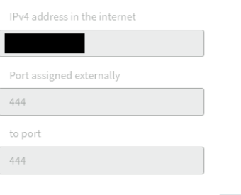

Hi @alzhao, please find the setup of the AR750 https below.
the external port looks correct.
i think that the internal to port should be 443, not 444
Hi @asdffdsa1122 as the field is grayed out, I cannot modify it. This field is automatically filled in when completing port values in “Port requested externally (IPV4)”.
that is strange, not to allow you to change the dest port.
there should be a easy way to change the web port on the ar750 from 443 to 444.
