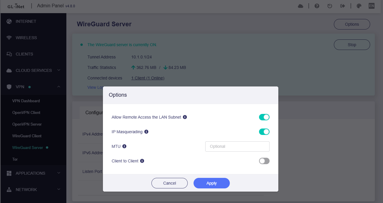

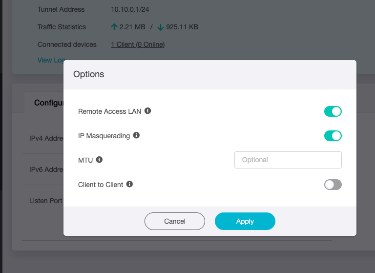

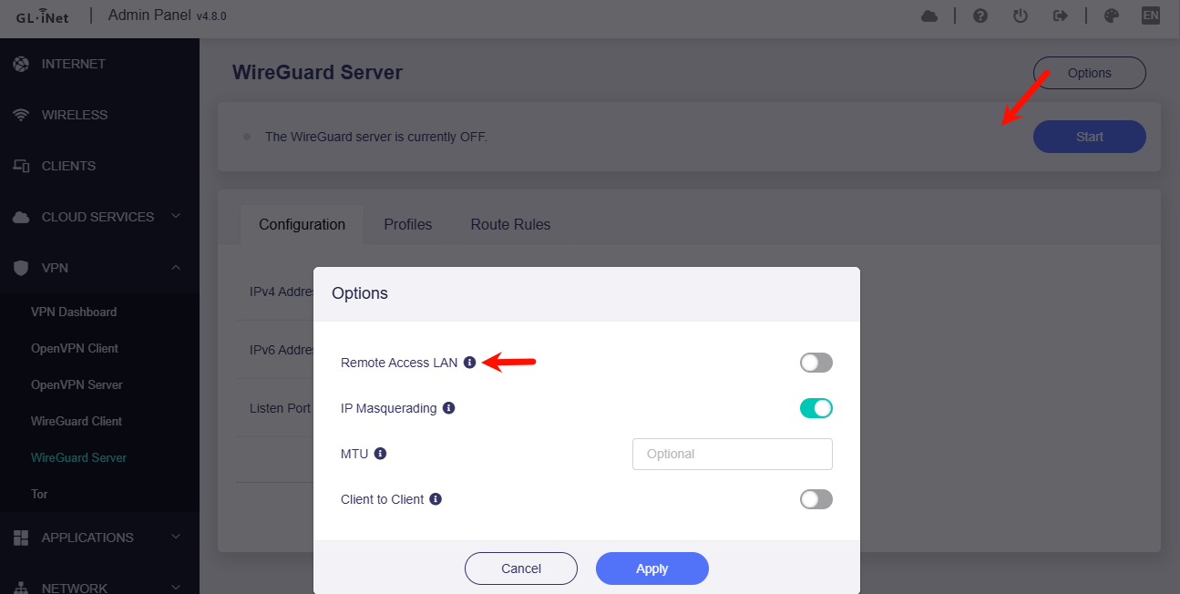

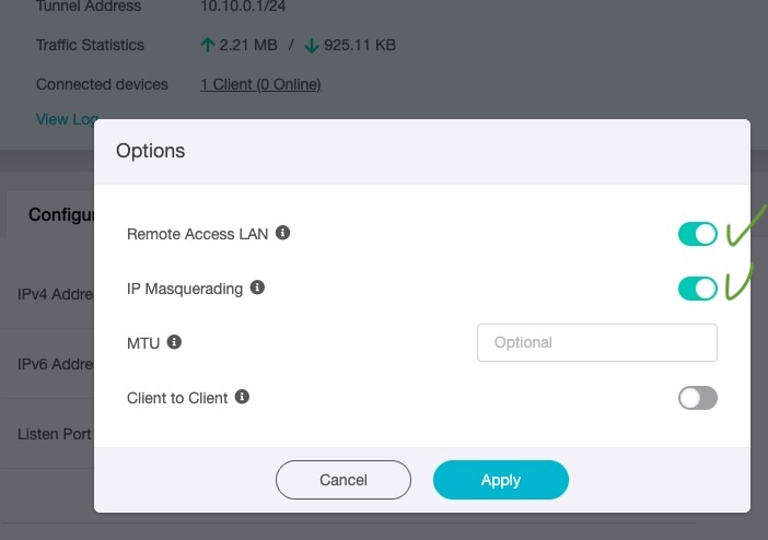

Did you mean "Remote Access LAN" feature of VPN server?
Yes
Unfortunately, starting with the beta version and in the snapshot from 2025-07-21, access is no longer possible, even if this option is selected.
I can only access the router; all others are unavailable.

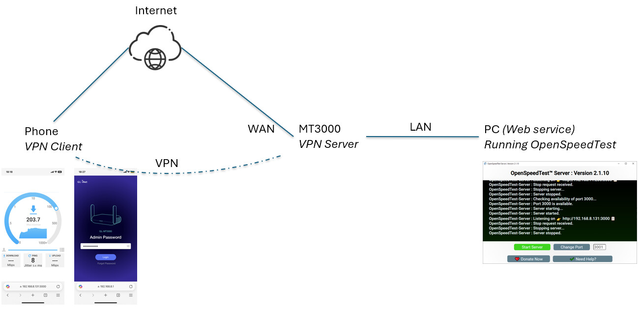

I don't seem to reproduce this issue.
WG Server: MT3000, v4.8.0 snapshot, 25th July.
WG Client: iPhone.
(Also tested in BE9300 as client, and iPhone connects to BE9300)
The topology is like this:
The VPN client is not only available to access WG server router (MT3000), but also MT3000's LAN client.
Please check your server routes first, if no luck, please let us know your network topology.

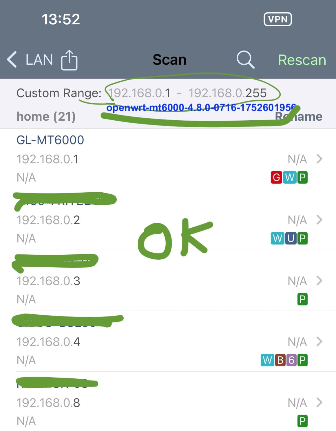

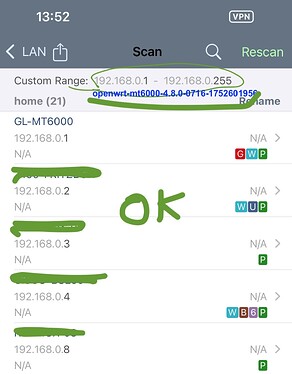

  • Firmware= openwrt-mt6000-4.8.0-0716-1752601956.bin
    All clients up to 4.8.0-0716 are displayed here.

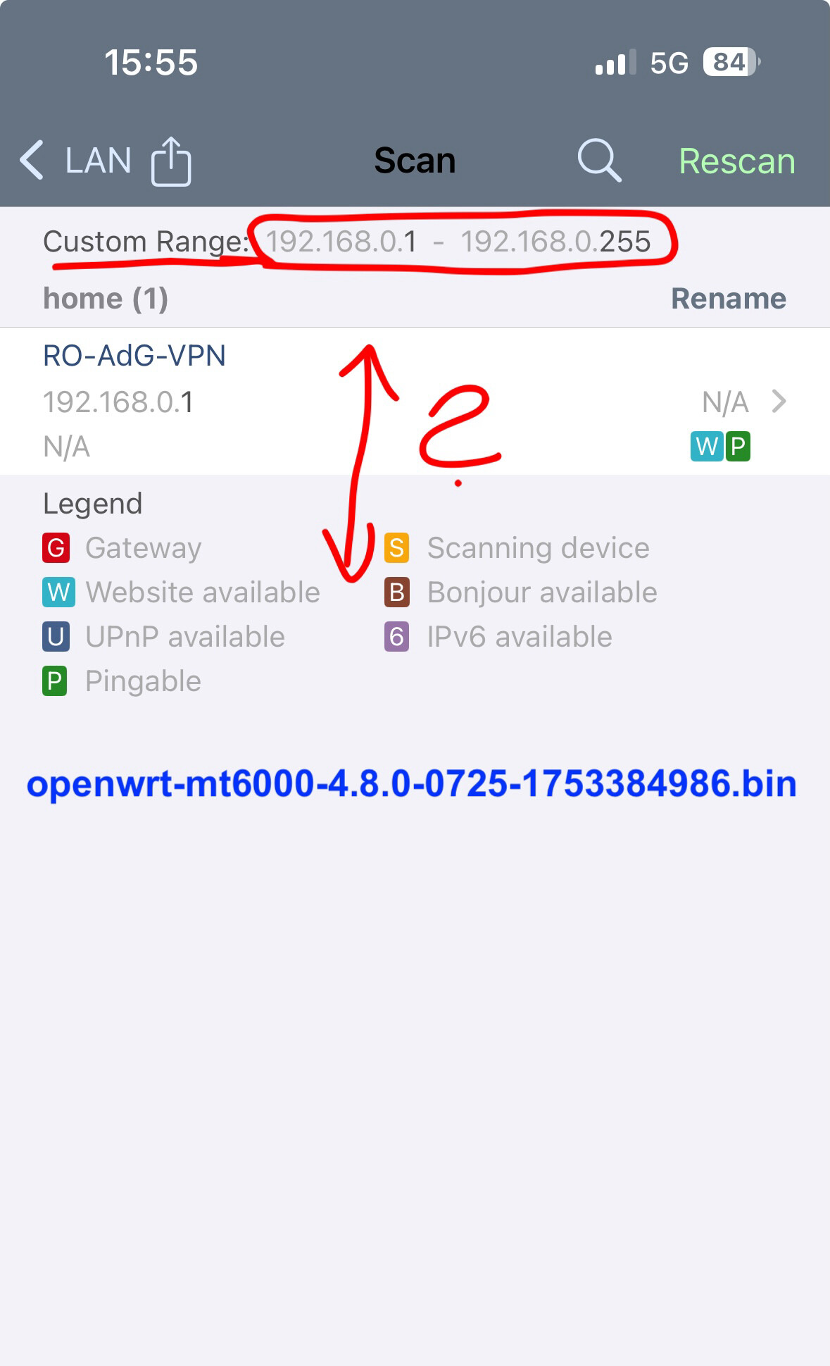

  • Firmware= openwrt-mt6000-4.8.0-0725-1753384986.bin
    From version openwrt-mt6000-4.8.0-0721 to openwrt-mt6000-4.8.0-0725, only 192.168.0.1 is displayed, and all other clients are no longer accessible.

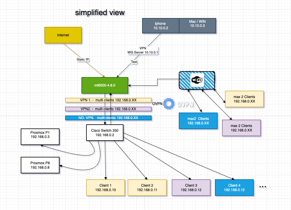

Please post a network diagram including any/all IPs inc. the WG tunnel.
I've just quickly summarized this.
As I said, up to version 16.07.2025, I had no problem accessing it via Mac or iPhone (VPN). As of July 21, 2025, I can only access the MT6000 router (192.168.0.1 or 10.10.0.1).

Good to know the topology.
Overall, it's roughly similar to my test environment topology, but different is your router enabled VPN client (tunnel) and with some policy rules.
Since I'm not reproducing on my side, if can, please share your MT6000 with us via GoodCloud and then perform uninterrupted ping [MT6000 LAN client] and ping [MT6000 LAN IP] in Mac/Win, I'll check the forwarding of these packages on MT6000.

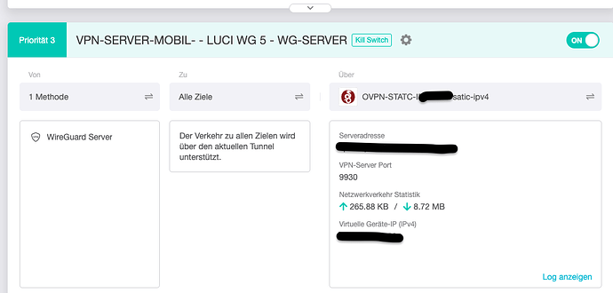

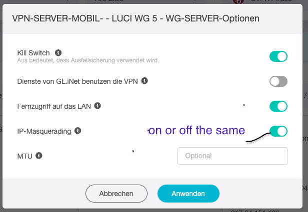

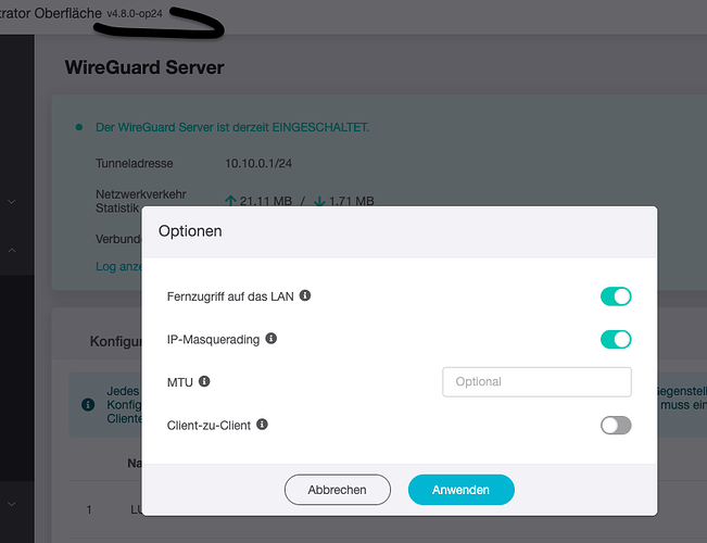

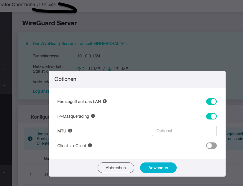

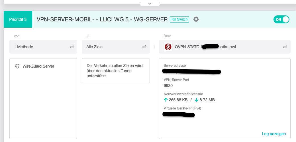

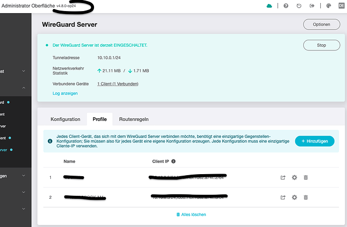

I've narrowed down the problem to the WireGuard server.
If the WireGuard server is configured as a tunnel, see screenshots, it doesn't work anymore, no matter what you set in the individual configurations.

Scenario 2
WireGuard Server with direct VPN tunnel
All Other Traffic: OFF, it's supposed to be VPN
-Access from iPhone mobile: OK MT6000
-Access to LAN: NO
-Access to WAN: OK
Access to WAN: via VPN TUNNEL: OK
Perhaps this helps narrow down the problem.

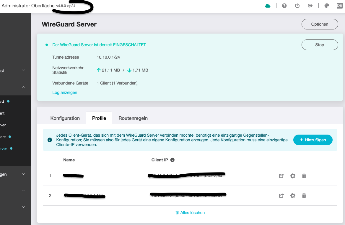

Here are a few more screenshots
