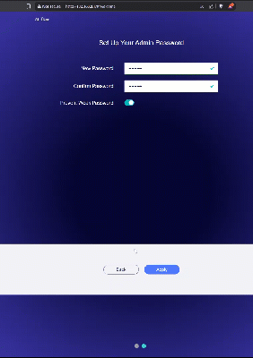

Reset to Factory bricks GL-A1300
I have bought two GL.iNET A1300 (Slate Plus)
and I will be returning both to Amazon...
The product should have never passed QA testing.
DDNS does not work, and Reset to Factory bricks the device and locks it in that state... The lesser products (Shadow and Mango in comparison are flawless)
No I won't spend further time (hours) troubleshooting this, You, GL.iNet staff can easily reproduce the issue and push a firmware upgrade. It's not something for your customer to fix...
  • Hostname GL-A1300
  • Model GL.iNet GL-A1300
  • Architecture ARMv7 Processor rev 5 (v7l)
  • OpenWrt Version OpenWrt 21.02.2 r16495-bf0c965af0
  • Kernel Version 5.4.179

The issue has been reproduced on two A1300 devices.
You have my firmware version and can therefore easily reproduce the issue at your end without taking up more of my time since you don't need me to fix this.
Good luck, I hope this gets prioritized...
PS: I was able to restore using uboot, but this isn't expected behaviour. a factory reset should not brick the device.
