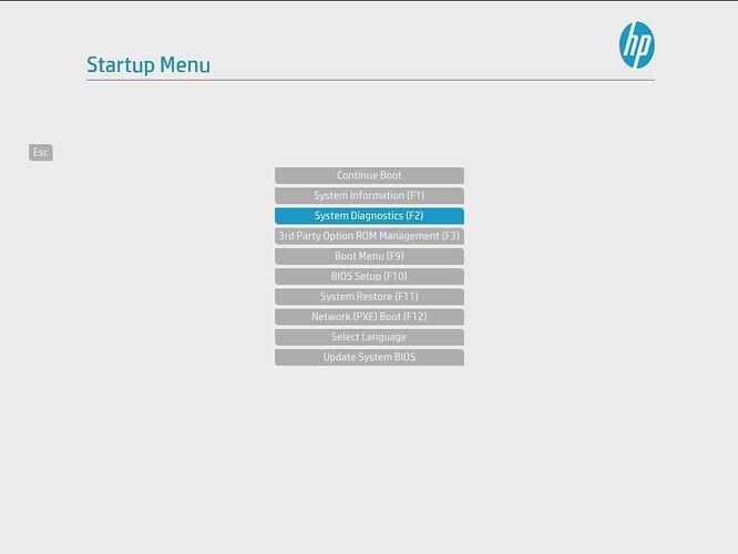

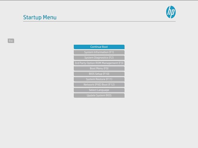

The test (screenshots attached)
One uninterrupted firmware session, parked at the HP Startup Menu, no reboot between steps. Only the Virtual Media function changed:
  1. Virtual Media off. Opened the Startup Menu by streaming Esc. Arrow Down works, the highlight moves.
  2. Virtual Media on (otg_functions?start_flash=1, image attached). Arrow Down and F9 now do nothing at all. Five consecutive screenshots are byte-identical to each other and to step 1.
  3. Virtual Media off again (otg_functions?start_flash=0), still with no reboot. The same Arrow Down works immediately, the highlight moves to "System Diagnostics".
There are only two screenshots below, and that is the point: the step 1 and step 2 screens are the same image file, byte for byte. The menu simply never changed while Virtual Media was on, so there was no second picture to take. The first screenshot is that unchanging screen, the second is the highlight finally moving once Virtual Media was switched off again.
