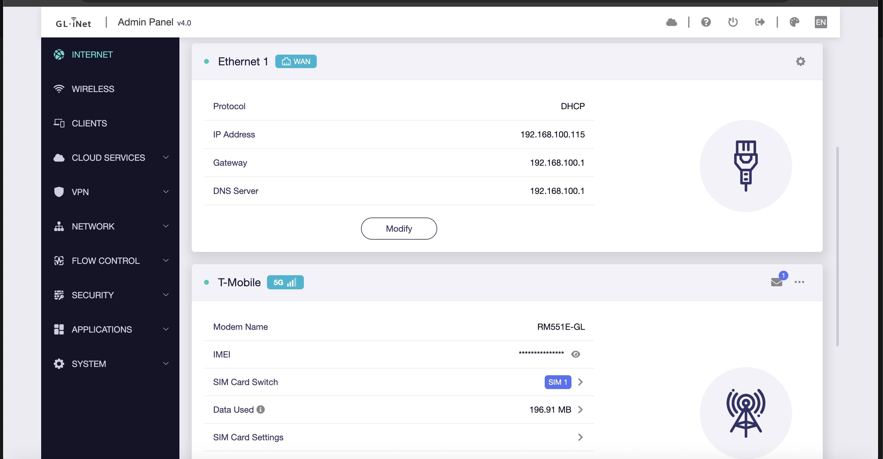

RM551E-GL fully working over USB with 3 small changes — please add support (still hoping for PCIe)
Companion to my other thread about the PCIe link not training with this module. Since
PCIe is out of reach for now, I got the Quectel RM551E-GL working over USB/QMI in a
GL-X3000 on firmware 4.9.0, using the stock cellular stack. Three changes are needed.
Everything below is verified across multiple reboots.

Result — the stock stack detects and dials the module normally:
"name":"RM551E-GL", "version":"RM551EGL00AAR02A02M8G_01.001.01.001"
wwan0 up with a public IP, default route metric 40
T-Mobile LTE, RSRP -92, ping 8.8.8.8 → 0% loss, ~65 ms

Thank you - that is immensely helpful to know and quite observant. I really appreciate you and Will taking the time to answer my questions and provide this info. I’m sure there are other people who will be just as eager to have this information.
Before I ended up reading these replies, I had decided to put the RM551E into an M.2 Ethernet enclosure and connecting it to the X3000 with the 2.5Gbe WAN port, which so far is working nicely for my purposes.
But when I have the time, I will revisit this and try to put the RM551E inside my X3000 again. I’ll report back when I do if this thread is still open at that point.
And while I’m here: a big shout out to GLi.Net for this product in general. My X3000 has been at the center of my life for the past two years, mounted in the back of a vehicle where it has dealt with extreme temperature swings on both ends, harsh vibrations, and constant use. The added features and constant firmware development are really encouraging to see when most other vendors seem to ignore what their users actually want.
