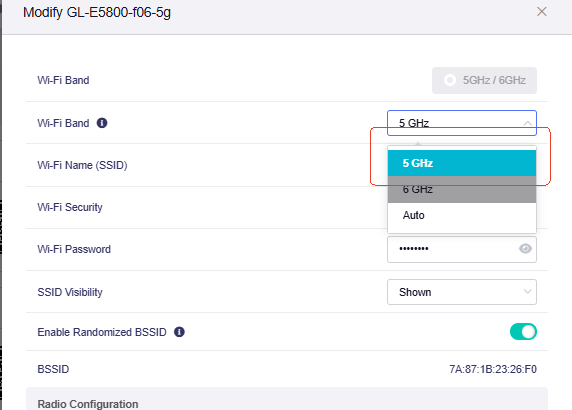

If the issue persists, please change the Wi-Fi Band setting for the 5 GHz/6 GHz network from Auto to a single band, such as 5 GHz or 6GHz only, and check whether the disconnection still occurs.
