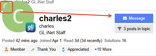

Please send the command output or screenshots to us via a private message.
