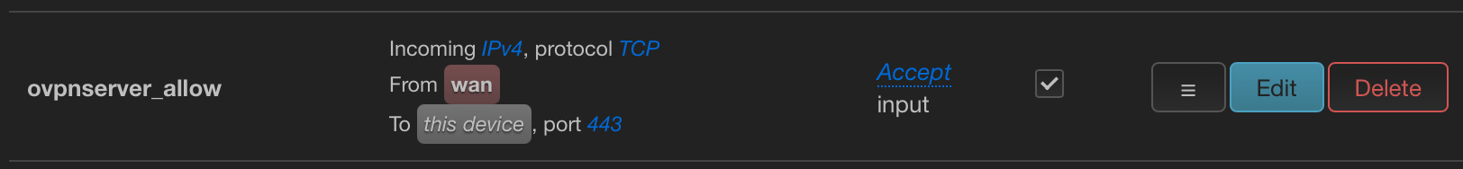

There is a firewall rule that I see in the LUCI advanced GUI that I didn’t create so it must have been created/changed by the GL.iNet GUI when I set the OpenVPN port.
Thanks appreciate it enabling that seems to have fixed it!
