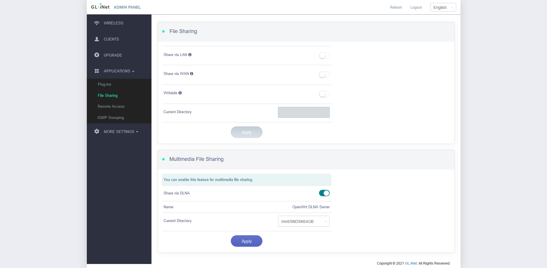

i finally got around to installing an SD card in the router
i found an issue that after installing both samba and dlna, samba does not see the partition under the sd card but dlna does see it. i thought it might be a sd card issue but why would dlna see it and not samba. can someone point me to a solution? thank you.
running Beryl with firmware 3.211 as an access point.

i just stumbled onto something weird while trying to set up the sd card.
if i plug in a usb hd/stick, samba recognizes the sd card. if i remove the usb stick, samba does not recognize the sd card anymore. does this mean that one of the modules in not loading correctly or is this a faulty router and i need to exchange it? i’m leaning towards software issues what do you guys think? thanks
PS sd card is the top and the usb stick is 2nd

The GL.iNet UI only allows 1 Samba share with default name GL-Samba, even when SD card and USB drive are both plugged in, which is why both appears in the drop-down list. The LuCI → Services → Network Shares page referenced in my previous post allows you to set up multiple Samba shares with your own naming,.
You can also view/edit the SD card, USB drive and internal mount points via LuCI → System → Mount Points.
