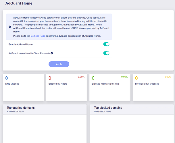

I ran the script to update AGH to 0.107.59 but now I no longer can access the dashboard. The landing page is now blank
I also frequently see the below error message throughout the UI
In the logs I see a whole slew of the below
Anyone have any ideas what's going on? AGH worked fine on 0.107.52 and I'm on FW 4.7.4

Strange, on Slate7 I by upgrading to 0.157.59 and .60 the AdGuard interface at IP address xxx.xxx.xxx:3000 turns out to be unreachable and the GL-iNet integrated interface turns out to be all 0
