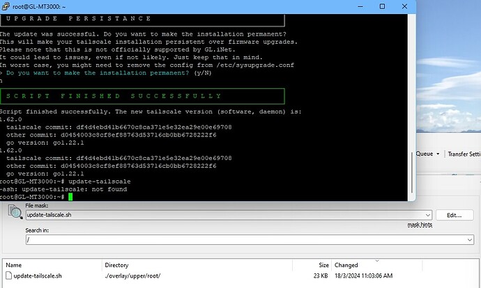

Hi, sorry to be a wee bit of a pest about this, but I tried to run just the update-tailscale script (both before and even after a successful "Quick Start" run) and it says not found.
I downloaded a fresh copy again as stated above and put it in the root dir as shown. What am I doing wrong?
Executing shell scripts works differently.
sh filename instead of just the filename
So in the case it‘s in root: sh update-tailscale.sh
Cheers that works! thanks a lot!
