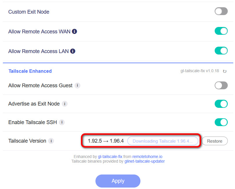

That is one brilliant enhancement Ken. Thank you for that. When trying to update Tailscale, It is just stuck on downloading and I wonder if there is any easy fix. Would also be great if you start a new thread dedicated for this great add-on.
Thanks @Lastimosa . Do you happen to have any adblockers (like Adguard home) running on your network? For the TS binary update, we just call Admonstrator’s update, which calls from his “admon.me” domain (redirects to github), but I’ve seen a couple cases where admon.me gets blocked.
Thanks again @rthco . No adblockers or weird DNS runnung here but still no joy. I have also used @admon great script and it works really well but I don’t like it forcing the tiny version for the Flint 2 and would like the full verion of Tailscale to be installed from the ouset of the update.
@Lastimosa Interesting.. I’ll have to look into the update hang.
