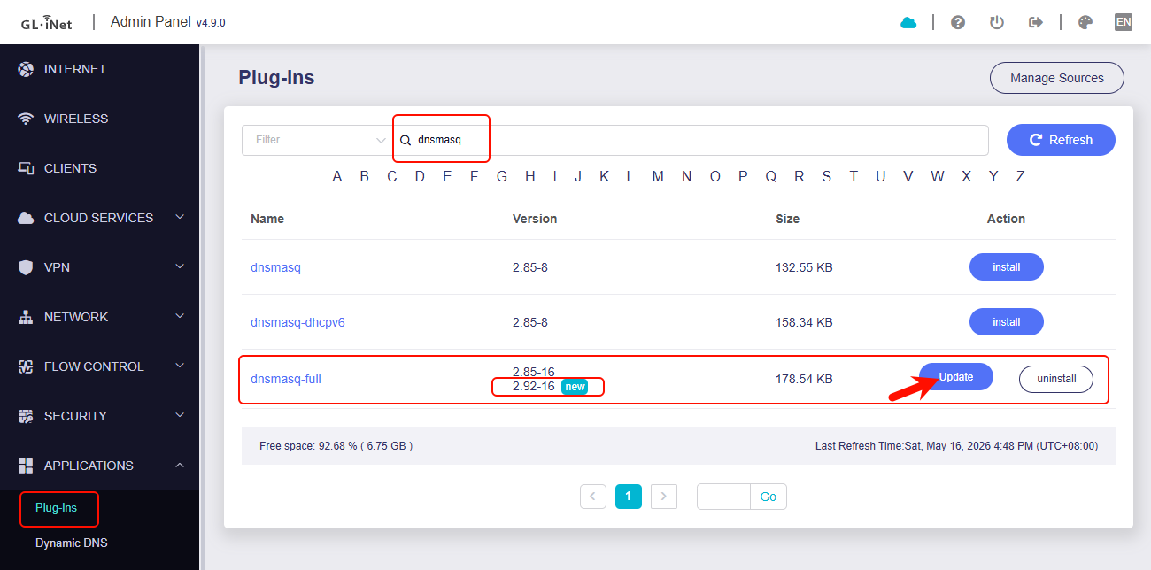

We have urgently built dnsmasq 2.92 for all router models and uploaded it to the GL repo.
Now you can get the dnsmasq 2.92 update in the following two ways:
  1. Log in to the GL GUI -> Application -> Plug-ins -> wait for the repo to refresh -> search for "dnsmasq", find "dnsmasq-full", and click Update.

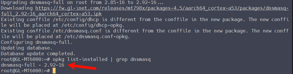

  2. SSH to the router and execute
    opkg update && opkg install dnsmasq-full
