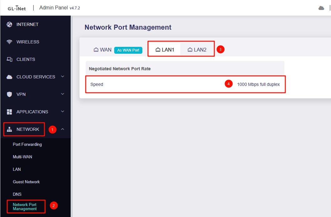

If your speed remains just nearly 10 Mbps, it may indicate an issue with the negotiated link rate.
You can verify this under Admin Panel > Network > Network Port Management if you are using the 4.7.2 beta firmware.
Alternatively, you can check directly on your device:
- Windows: Settings > Network & Internet > Ethernet > Aggregated link speed
If the negotiated rate is 10Mbps, please try the following:
- Replace the Ethernet cable
- Connect to a different LAN port on the SFT1200
