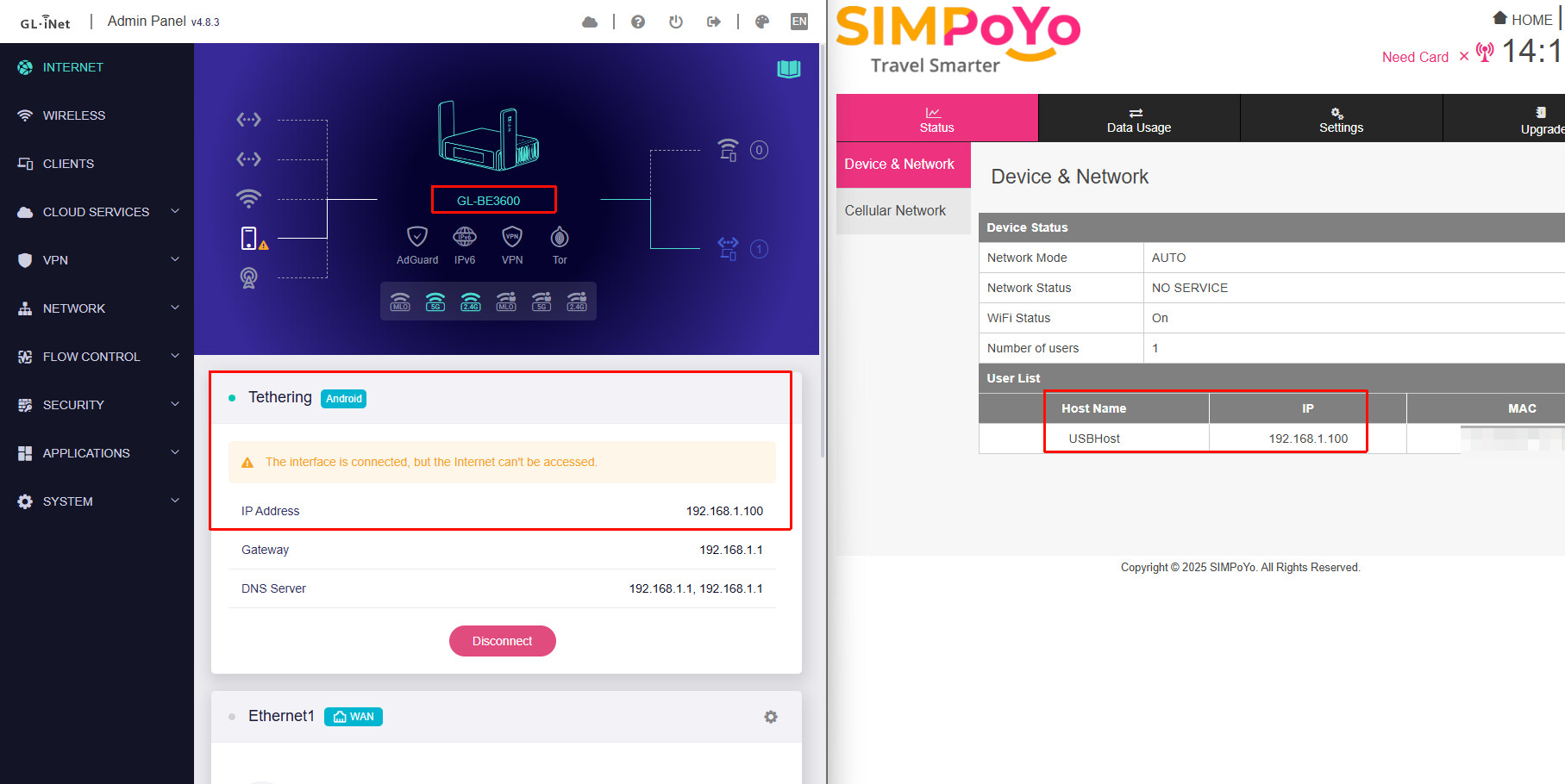

We tested this locally using the BE3600 (v4.8.3) with a SIMPoYo 4G uFi, and devices connected to the BE3600 were able to access the SIMPoYo admin panel without any issues.
Please check the following:
  1. When accessing the SIMPoYo admin panel in your browser, try entering the full URL with the HTTP protocol — http://192.168.1.1, as SIMPoYo does not support HTTPS
  2. Make sure the device connected to the BE3600 has only one active internet connection, and that no other network interface is using the same IP address
thanks for replying, i did the same test and it worked! I was keeping the repeater mode enabled and so i was not able to access to the SIMpoyo admin panel, once i disabled it and kept only the tethering it worked.
Thank you for you help!
